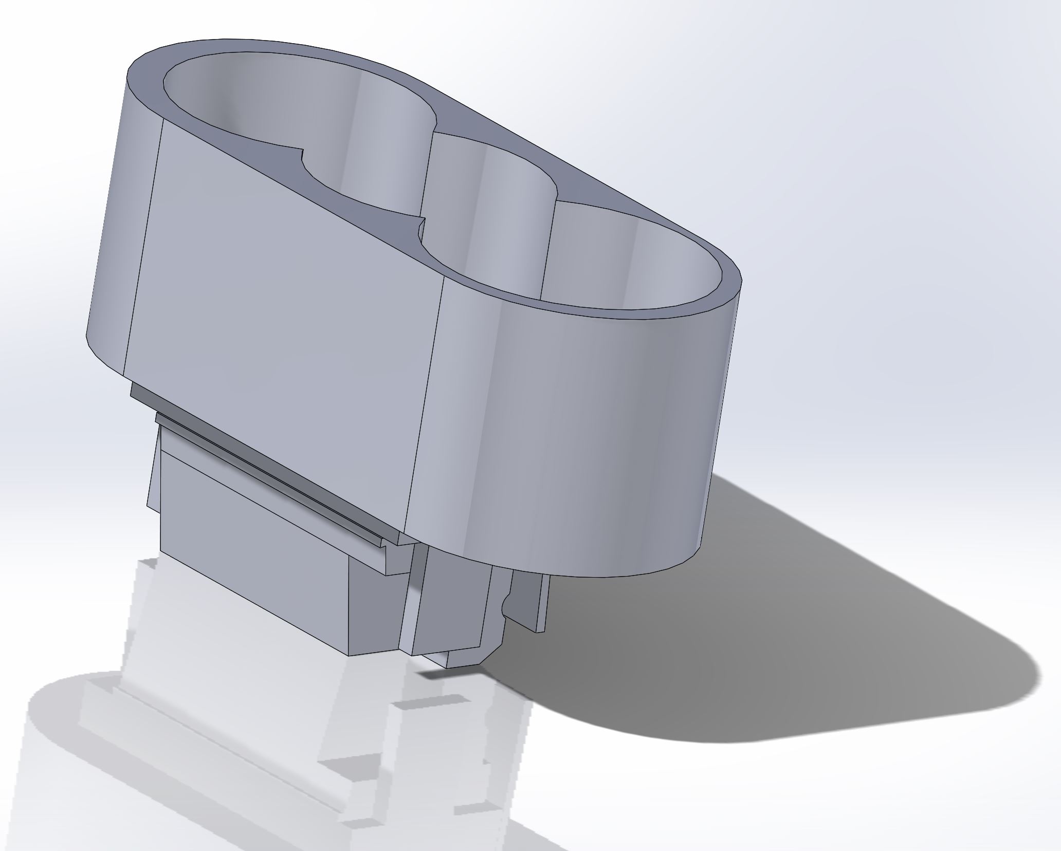

I recently removed my cup holders in order to install a double din stereo and needed to find a new way to store a drink. I saw some threads about 3D printed ashtray cup holders but it seems like the stl files got removed. I took it upon myself to design my own based off of pictures and plan on printing it this weekend, check it out
*edit*
just printed out first prototype. need to make some adjustments but overall i like it so far. see second photo

Looks nice, but unfortunately it doesn't look very functional to me. I don't see anything that keeps the cup from tipping over.
The holder needs to be much deeper to keep the cup in place during braking and turning.
It's a great idea, though!
Just a suggestion and good luck with your project!

Working on adjustments to the design. Did not fully print the cup holder piece in order to save filament and just test fit the ashtray part. Future prints will have taller cup holder though
