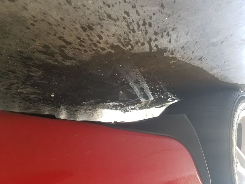

Also, after picking it up from the shop after they did the tie rods I drove 4 miles to my home and the coolant started errupting from the cap. The tank is not cracked, no leak in the trunk floor or any of the other tricks ive learned on here, it definitely came from the cap. (pic below) When i called the shop he said they did top off my coolant and to send him some pictures. When i called back he walked it back and said they actually didn't top it off because they shined a light into the tank and it was full. I am sure it was the cap, and maybe it wasn't any fault of theirs, but that shift on their response made me question their integrity. I got a new cap and haven't had any issues yet with driving 60 miles.

Coolant overflow is above the right rear, it looks like that's where it was leaking. It's a classic sign of an air bubble in the coolant system, normally from topping off. Remove the oil and coolant caps and pry the plastic trim up with a flathead screwdriver, there's a purge valve, flip it open and drive it like that for a few days to let any air out.
