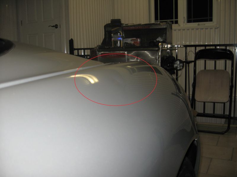

Yes the upper quarter panel area can be accessed removing the tail light.
About 27-28 inches deep. After that there is a transversal plastic support bedded in yellow foam.
Lucky because the ding seems to be a inch before that support.
The access is at the leftmost hole. See the red circle on the pic below.
Again thanks all.

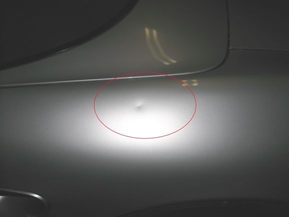

Yeah...finally we end up by drilling a hole in the inner fender. The PDR guy said that thru the tail light was too far from the ding to have enough leverage.
Very satisfied with the result. It is back at 99 %
Impossible to see by someone who dont know where exactly the ding was.
It was his first Boxster. He said the metal sheet is thick like hell and kind of difficult to work with. But end up pretty well.
Before
After
Again thanks all for your input !
