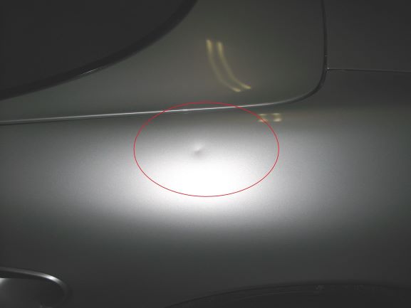

Tomorrow a PDR guy will come here for a small ding on the left quarter panel. The ding is above the rear wheel maybe 7-8 inches toward the front.
Can this spot be accessed if the tail light is removed ? I also heard that it could be accessed by removing the intake grill but tricky since many clips can break.
Also I want to avoid drilling the inner fender.
Any input on this ?
TIA

pomerlo 06-10-2019 07:08 PM
Yeah...finally we end up by drilling a hole in the inner fender. The PDR guy said that thru the tail light was too far from the ding to have enough leverage.
Very satisfied with the result. It is back at 99 %
Impossible to see by someone who dont know where exactly the ding was.
It was his first Boxster. He said the metal sheet is thick like hell and kind of difficult to work with. But end up pretty well.
