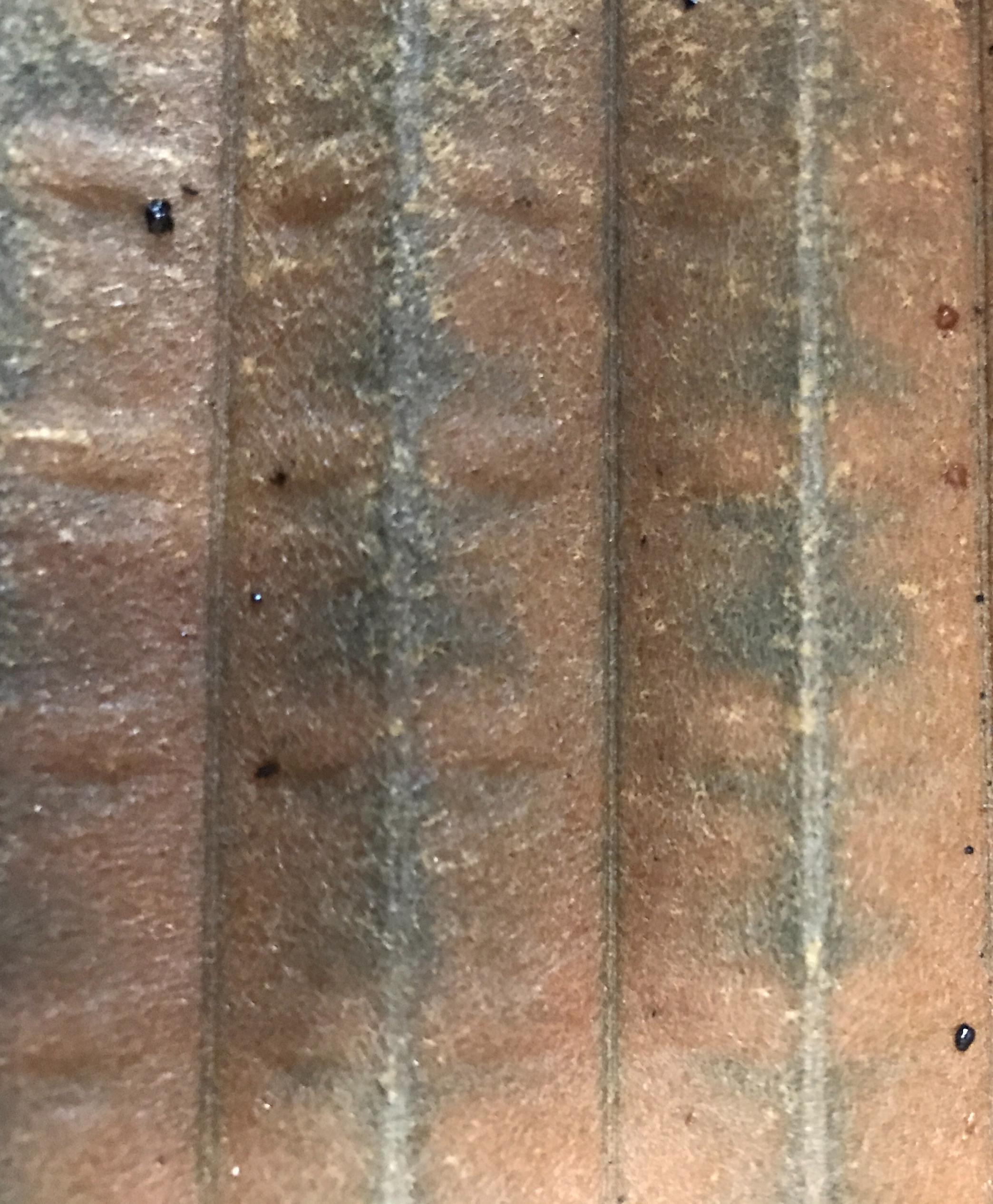

Looking to the group here for a little guidance. I changed the oil in my car yesterday and performed an inspection of the filter element. The good news is that a very thorough inspection finds absolutely no visible metal particles. But, I did notice about 10-12 dark brown hard particles that appear to be a form of plastic or Bakelite type material. Most, if not all, had rounded edges as seen in the picture attached. I know a lot of people have much more experience than I do with this, so any thoughts on what this could be would be helpful. Additionally, any preventative actions I should take would be appreciated.

I need a dry close up but you might be looking at vario cam chain pad particles

Well, if they’re not bedbugs, they’re probably chain pad bits, like jaykay said. You may want to check your camshaft deviation readings.

Chain guide ramps, or as the other said +1 with Newart

How many kilometres.....sorry miles / hours on the engine? You will likely not get an out of spec deviation if this is the first instance of particles.
When I had paper oil filters....I found that use of 0W40 yielded quite a few of these particles early in my engine's life....later after switching to 5W40 the number of these particles were reduced.
Driving style could affect this wear. IIRC theses pads are significantly more loaded under 3000 RPM and that this wear condition changes every time the 3K threshold is crossed (early 5-chain motors). There should be plenty of anecdotes from M96 engine experts here.

Light or dark brown particles are varicam glides/pads. They can be replaced by taking off the cam covers. Some have done that with the engine in car but most drop the engine and replace.
Black color particles are the chain tensioner pads. The IMS Shaft to cam tensioner pads on each bank can be replaced (2 on each bank) and the engine will need to be removed. The Ctankshaft to IMS chain tensioner pad cannot be replaced without a total dismantle of the engine.
Check your cam angles and drop your oil pan and take a closer look inside the sump for more debris.
