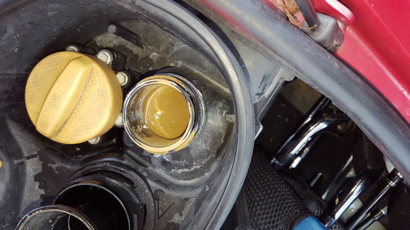

Eastcoastmod 05-28-2018 06:30 PM
here are a couple of pics of the oilhttp://986forum.com/forums/uploads02...1527557038.jpghere is the dreaded sludge
http://986forum.com/forums/uploads02...1527557335.jpg This oil is only a few hundred kms old.
http://986forum.com/forums/uploads02...1527557400.jpg I tried to make a shadow so you could see it better.
rexcramer 05-28-2018 08:37 PM
IMHO, I seriously suggest that you don't run it anymore until you find out WTF is going on. You may make a minor problem something considerably worse.
