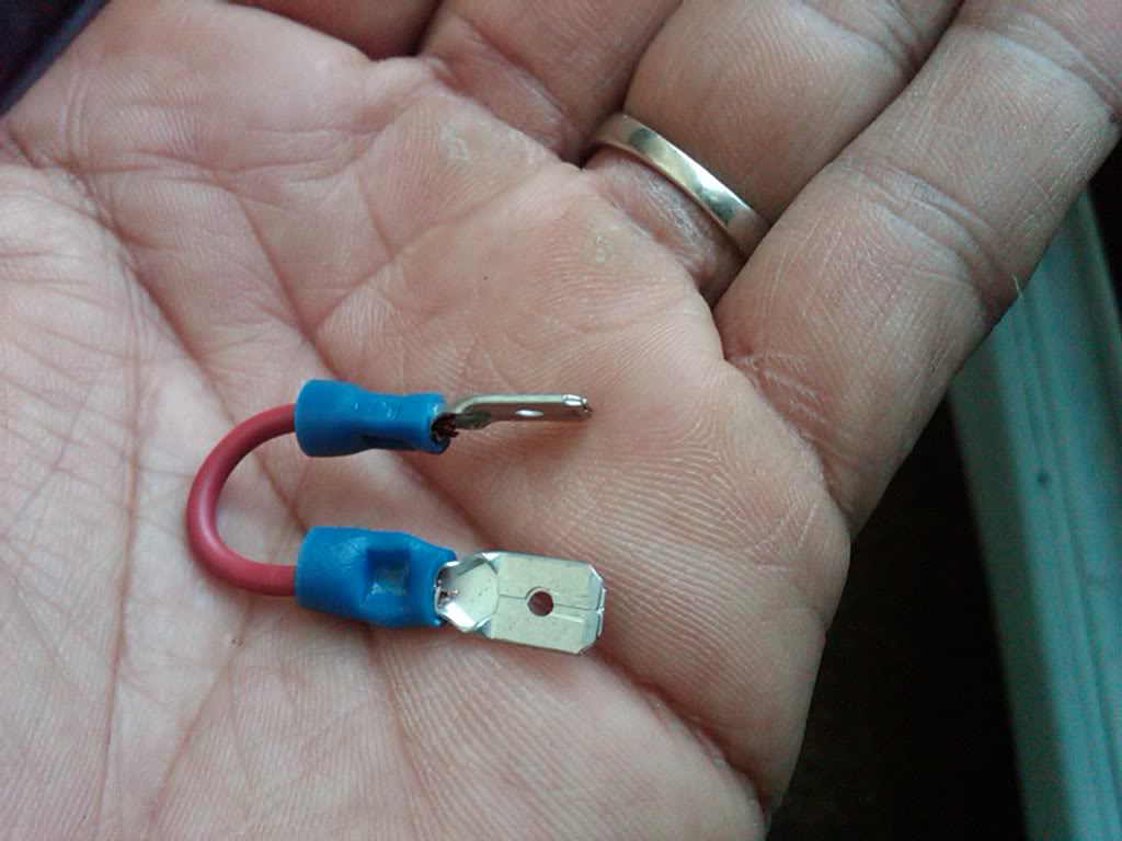

Hi, I'm trying to drain my fuel tank of old fuel and am trying to do the jumpered relay for the fuel pump trick as detailed on pellican. does the jumper have to be a certain gauge of wire to work? I can't seem to get it to work with random bits of wire that I have lying about and am wondering if that's my issue.

You obviously don't want to use a tiny wire, but it doesn't need to be huge, either.
You're most likely not hitting the contacts in the socket. Use proper sized spades.
