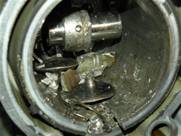

Only runs on one half. The other half looks similar to this........when forged aluminum and hardened stainless attempt to occupy the same space....BOOM... Blowed Up!
