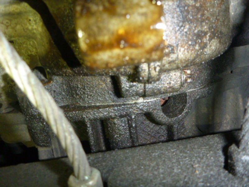

1: small oil dropping bottom of the engine where it mount to trans. Does the oil leak look like leaking from rear main seal?

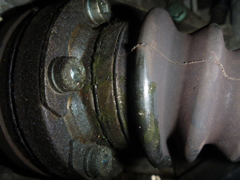

2: both left & right inner axle shaft inner boot to trans. clamp is on the boot right side worse than left. I didn't see any tear on the inner boot. there is some grease that spattered on the right side front of the boot to engine. I can turn the inner boot easily with my hand again the clamp is on the boot there's some grease as you can see from the photo coming out. I shouldn't be able to turn the boot with my hand right? is inner boot clamp even though is on the boot worn and should I replace the clamp?

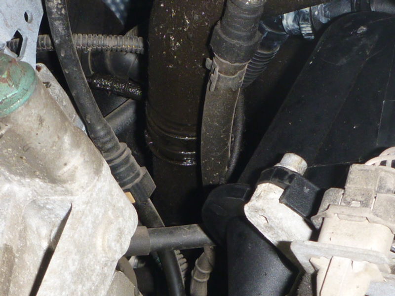

3: i'm guessing the top hose is coolant hose. The hose below the coolant hose looks like was leaking at some point and the leak as you can see hardended. What hose is the hose below coolant hose what can this hardened stuff be?

You have a coolant leak, likely a bad water pump. They are known to fail on these. That is your biggest problem, the oil and axles are fairly common as well and won't cause problems in the near future, that water pump however will leave you high and dry so I recommend getting a new water pump and T-Stat.

Ok so the leak dropping that is hardened is that part of the water pump ? .I have been driving the car often that leak doesn't look fresh looks old.
I cleaned off the excess oil leak you say oil leak and axle boot grease leak is common. I will have to keep an eye on both. I may replace the clamp with one of those aftermarket one you tighten by screw driver. Do you think oil leak is coming from rear main seal??? Thats the only place I can think of or could it be from oil filler tube? I have photo of the oil filler tube looks very wet and leaking. Fourth photo is photo of the oil filler tube as you can see tube is pretty wet.

The oil leak is either the rear main seal or the intermediate shaft bearing, both of which can be serious and required taking out the transmission to diagnose the problem. And if you get to that point, then you probably just want to replace the rear main seal, the intermediate shaft bearing and the clutch at that time.
I second the diagnosis of a bad water pump and the leaking CV joint boots are easily fixed by replacing the original clamps with worm style radiator hose clamps.
I hope not leaking at the intermediate shaft bearing I hope it's the rear main seal. I know my car has 10% IMS bearing failure rate and my vin does fall under the defective IMS failure from Porsche. Looks like IMS bearing is original bearing on my car. Now I'm even more worried of the infamous IMS bearing failure.
Maybe time to try to sell the car..... But I do love the car but I'm not mechanically inclined and it cost too much to fix car problems as it arises at a shop.

Did you examine the oil filter for debris. If there is no metal then the IMSB is probably ok. But I would still drop the tranny
If you have a lift it's really pretty easy to drop the tranny.

I will examine the oil filter this weekend and see there's metal shavings. I will post the photo here. My work has a lift but it's 25 miles away no way i will be able to drop tranny and do the work over the weekend. Probably take me a week to do this and have never done this let alone on Porsche. I will have the shop do the IMS bearing and rear main seal when the clutch need replacing. Although clutch feels solid and may have been replaced already. If clutch was replaced then I would have to make a decision when I'm going to have the IMS bearing and rear main seal replaced sooner maybe at 90k miles.
