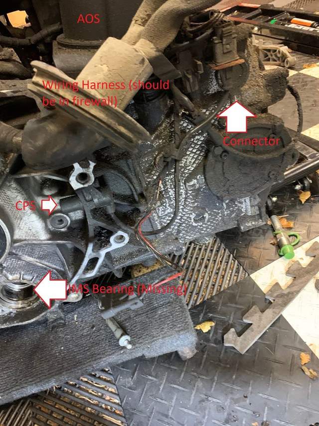

Hopefully a clearer view of the sensor and connector......
-Eric
-Eric
Are they the ones circled?
On a serious note... how about circling the parts, for us neophytes.

Better? (circles came out messy)
-Eric
