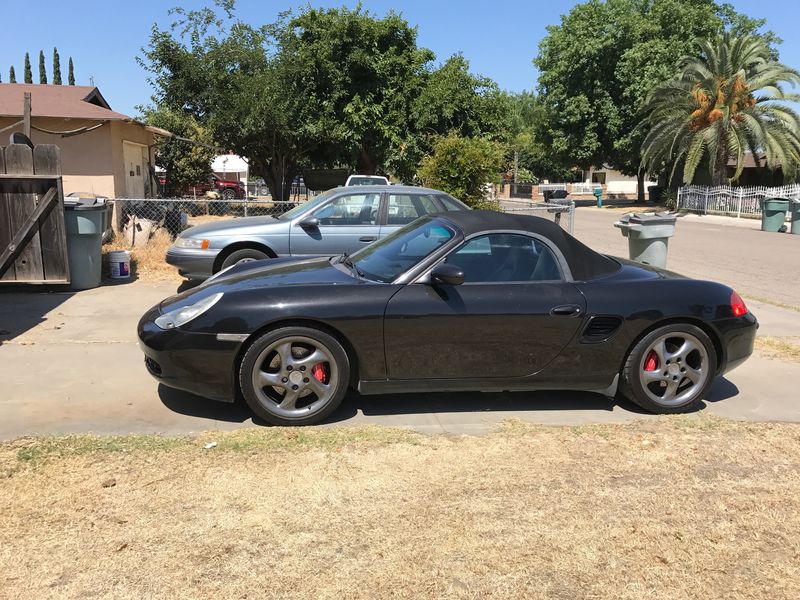

Just a couple of photos of the car.

Nice looking car and nice options. I hope you enjoy it! The VIN website thing doesn't say what the individual option costs were but the base price for a Boxster S including the delivery charge was probably about $50k to give you and idea of what the options added to the cost. Bose was the top audio option, but if you have door and rear speakers, then you at least have something. You can also see if there is an amp in the front trunk with the CDC-3 changer. Part of the "comfort" or "design" packages may have been some audio upgrades. My car is a 2003 S and it had no audio upgrades at all. Just the CDR 23 radio and speakers in the dash only.
