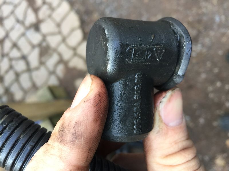

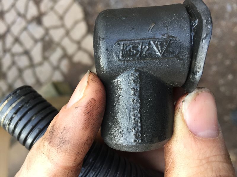

Did anyone ever post the grommets part number? The photo is not working for me.

Did this last weekend and found a few tips that were really helpful. 1. Get a set of long needle nose pliers (I used an 11" set from HF cost about 3.99$) 2. That grommet is really hard to get into the underside of the car unless you wrap the fishing line around the groove of the grommet.
Part Numbers for Driver side are
996 504 646 00
996 504 643 00
999 513 049 00
