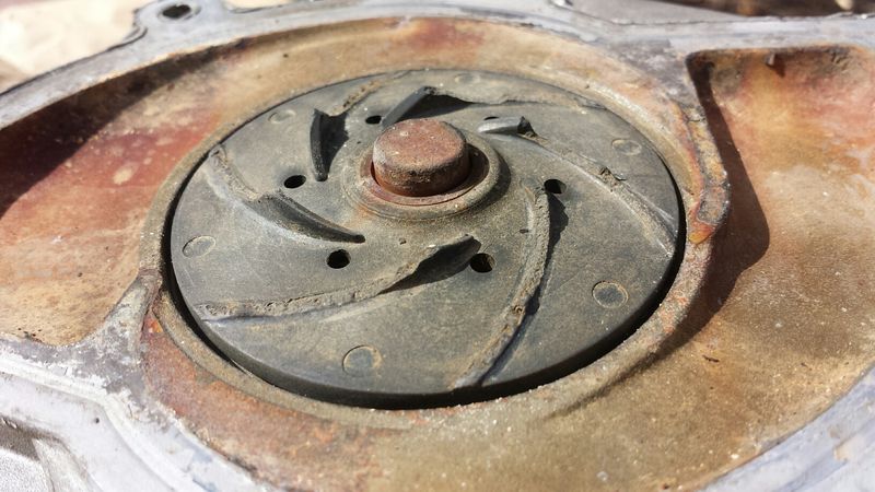

...and here are two OEM water pumps that I've pulled from cars shortly after purchasing them:
A 'new-to-me' Boxster will get a new pump and flush unless it has a recently documented replacement.
