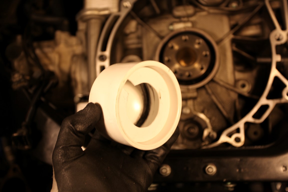

Is there an easy way of setting the depth of the seal?
How critical is having the seal at a certain depth?

The seal goes in to the mm and sits just inside the old wear point. I used the bell end of 3"PVC and it was the perfect install tool. Then set a small depth gauge.
You drill a hole in the old one then put a screw in that hole and remove. Don't push it into the motor.

As Timco said a plumbing fitting works like a charm...just make sure you have your depth set correctly as the new RMS has a critical depth.
Great Design....
What did you make the stopper out of?
Did you glue it in place?
Cheers!
