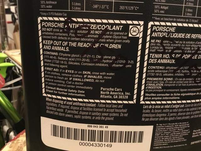

The current coolant Porsche is selling for our cars is not OAT.
As proof, note the word "silicates" appearing on the ingredient list of Porsche's most updated/current coolant...
The part numbers of this particular jug are: 000 043 301 49 on the back, and "G-40-91-EF" on the front:

Looks like this could be the type (Porsche approval):
G40® | Glysantin®
So it's a silicated-OAT, then (also considered a HOAT).
Per Glysantin, G40 is used from 2010 onward, G30 from 1996-2010, and G48 up through 1995.
http://www.glysantin.de/fileadmin/Files/Downloads/Publications/BASF_Glysantin_Zulassungen_EN.pdf

The bottle jakeru shows is the newer G40 stuff.
