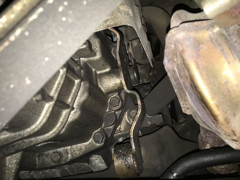

Hi all, have a question. I noticed some oil - looks feels and smells like engine oil.
2002 Boxster S
Got under the car and it looks like it is coming from the right side of the tranny. Assuming some sort of shifter? Pictures attached. Thanks!

It's the shifter bushing in the trans housing. I had mine fixed by pressing in a roller bearing and a new seal. If the shaft is worn you'll need the shift lever.

Thanks! So no need to drop the transmission or anything? Easy fix?

Drop trans. Pull gear box housing. I did this and have pics.
Then find an Indy that will do this. My guy got creative. A new housing is about $900.

This is a very common issue and there are fixes but cost to do it is an issue. Mine 'weeps' but not a lot . I live with it for now since there is no harm to the tranny and none of the oil makes its way to the ground.
