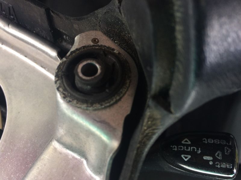

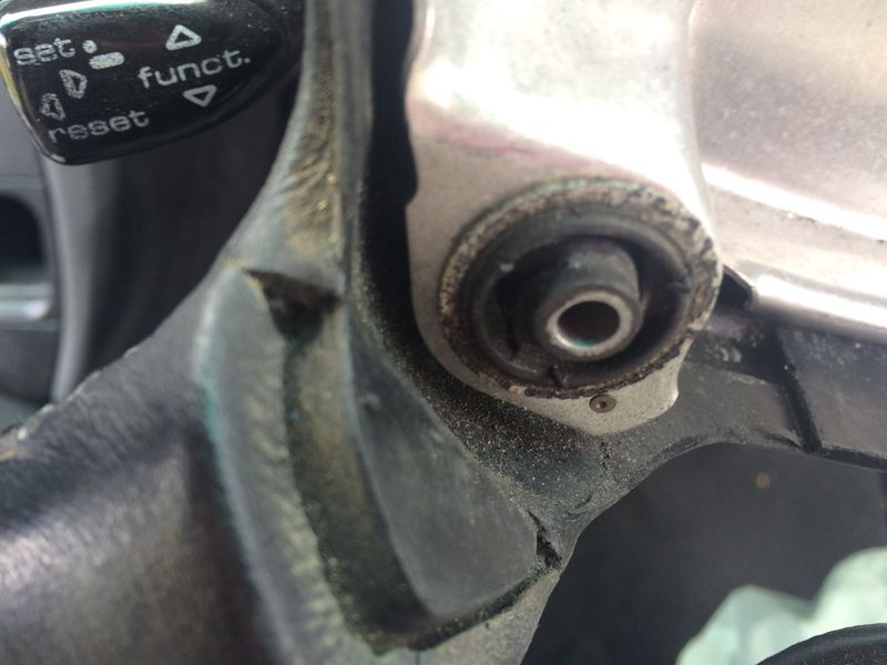

The bracket bushings look completely shot.
I don't think the #31 o-rings to supplement the worn out bushings are gonna be big enough.

@More : I ended up putting o-rings on the back and front of mine to fix the issue. Basically just pack them in there until you prevent the metal contacting, but not too much to prevent you being able to press the horn still. Also as you're in Aus, if you need more o-rings, Bunnings sell a mixed pack for a few $ and it contains ones that are a suitable (if not exact) fit, worked for me anyway.

I just made washers out of dense foam rubber. It's hard to explain in words...pictures would have been better, but I didn't take any.

Well I put the o-rings on front and back and now the horns not working at all.
