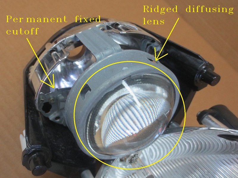

It will make your high beams seem brighter, but light output will not change. Litronics have a fixed cutoff shield that always blocks half of the beam, unlike bi-xenons.
No, self leveling will not make them any brighter or sharper, it just makes it look that way. Pointing a flashlight slighter higher doesn't make it any brighter, but merely changes the path of the beam/coverage area.

With factory Litronics or any other factory HID set up, when you turn them on, the beams swivel up and level to a set position (yes, you can still adjust the vertical and lateral position of the beams through the trunk). My guess is that since that car you were working on was retrofitted with aftermarket connectors, and that they were disconnecting, that they were then not lifting up the beam upon startup like they should, and therefore, the lighting aim would of course be off. In contrast, in my set up, since I don't have the electronics installed, the projectors will not move at all during startup or shut down, and therefore, they stay in the fixed position at all times. Therefore, all I have to do is to properly aim my projectors (through the front trunk openings as stated in the manual), to get at the desired height level, and then the projectors will stay at this fixed position at all times. Therefore, I would never have the problem of the beams not leveling up to the right height because they are already fixed in the right height. Therefore, your example here is not applicable. My beams are set at the right height...it's just that they don't ever move from what I set it at to account for weight changes in the car or a swivel up of the xenons to help the halogens upon high beam application.
As I discovered, when I turned on my friend's car with the factory Litronics, the beam would swivel up upon startup and then swivel down upon shut down. So, after I installed his lights into my car without the electronics, the beam would be too low because I didn't have the electronics in my car to make the projectors level up. Therefore, to get around this, I had to manually adjust the beams up to the correct height, and then they stayed there at that level at all times. Now when I turn on the headlamps, they are at that same height all the time, and when I turn the lights off, the projectors also don't move so that when I turn them back on, they are still at that fixed height. And regardless of what car the headlamps were in, they still are not as good as the modern set ups.
Oh, and you definitely can adjust the aim of Litronics. It's covered in the owner's manual. There are 2 holes that are plugged inside each side of the trunk (behind the carpet). One changes the height of the beam, the other changes the lateral positioning. That's how I moved the beam of my Litronics up.
