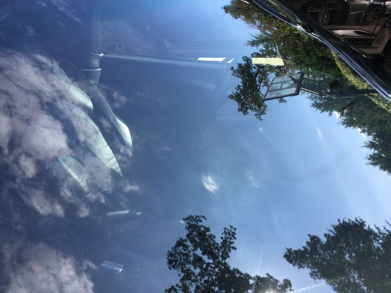

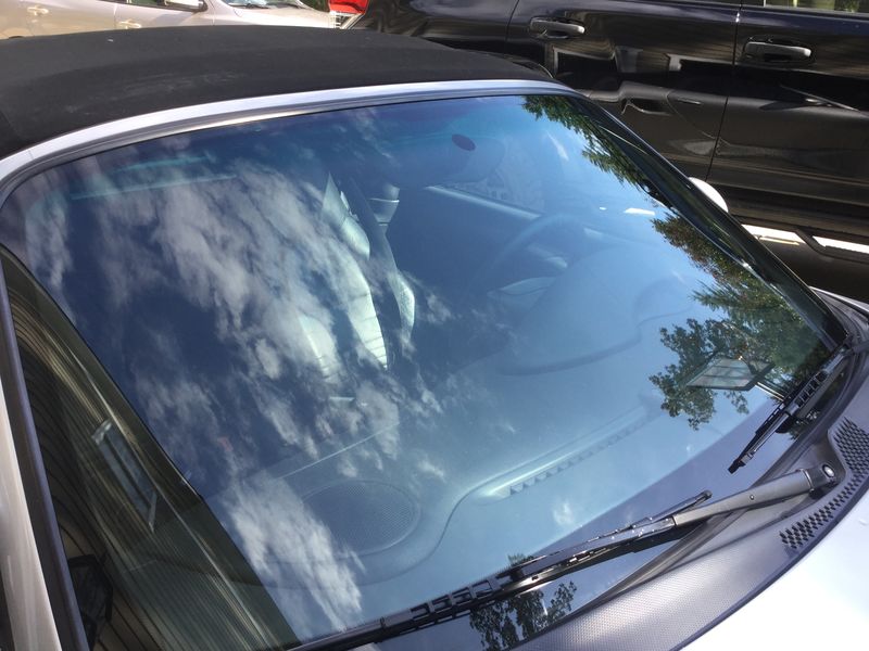

Old 09-23-2016, 01:00 PM   #3
Join Date: Jul 2012
Location: Charlotte
Posts: 70
Just after...not before. Here you go.

Wow that looks great

That looks good.
