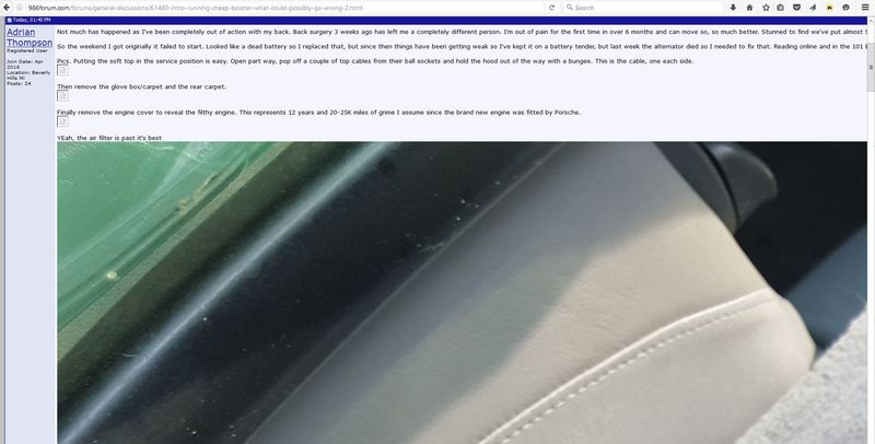

Adrian Thompson is offline   Reply With Quote

Tried to read your thread but but couldn't continue due to the size of your pics.
Yes, good thread, but on my PC the size of the pics is way too big. Here's what I see:

Holy ginormous pictures, Batman!
I can't read your posts because the pictures are far too large.

OK guys, let me know if you can see the pics and read it better now. I've resized all the pics so hopefully you can see them on the screen. It's funny, the other forum I post on GRM has the most god aweful forum software the seems like it was designed in the early 90's, but the one thing it does fine is re-size images with no issue.
LEt me know if this works for you now.
