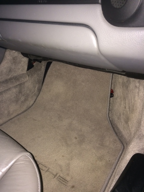

Active sub in tight space
This is my hidden active sub under the carpet & passenger foot. Only 2.8'' deep. Great sound!

For those that put the amp/sub in the front - how is the vibration? If you have a passenger in the seat - are they getting a strong vibration from the floor or the seat (depending on where the sub is). Any feedback? I'm looking at putting one of these in somewhere and hope due to the small size they aren't causing much vibration....but I'd like my passengers to be comfortable.
Not much vibrations on my side. My wife is not complaining at all.
