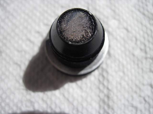

Following up I changed the engine oil and the oil pressure relief piston and spring today. The old spring and piston were fine, bolt has wear from the spring. New improved piston has the bevelled top.
No iron on the magnetic drain plug. Good! :dance:
