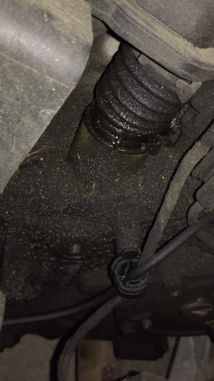

Vacuum oddities
The mystery is solved, and I didn't even have to check the EVAP system! No wonder the propane wasn't having any effect...
epapp is offline   Reply With Quote
Attachment 19687
What was it? Oil filler tube?
stelan is offline   Reply With Quote
Old 11-12-2015, 06:19 PM   #12
epapp's Avatar
Join Date: Aug 2013
Location: Bay Area
Posts: 700
In the picture is the rubber tube connecting the crankcase and AOS. It had a large tear in it.
