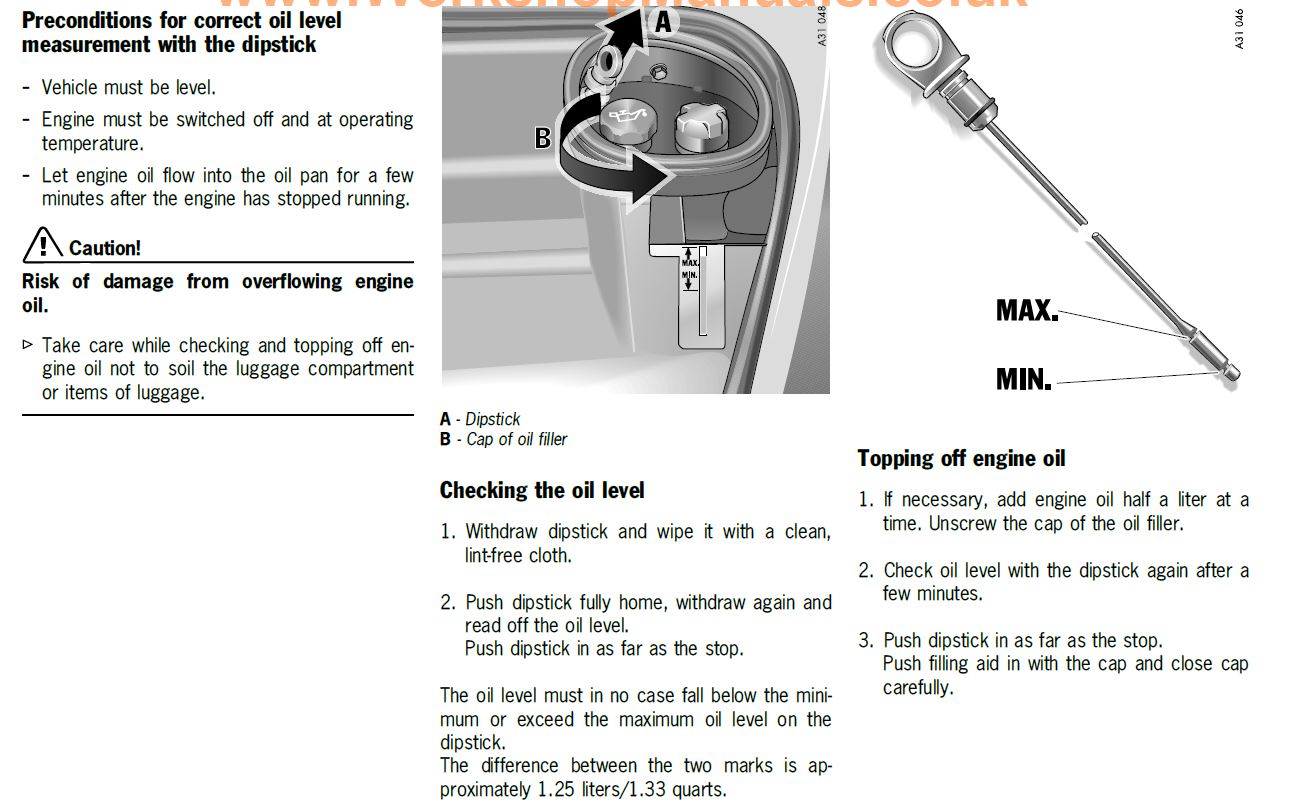

I changed my oil today and used mobil 1 0W-40. It was overall very interesting and now I understand how the engine and everything else is placed. The engine sounded and felt so much better after. Best part was the look on my friends face when she saw me pouring oil in the trunk lol.
Only problem I have is that I filled 9 quarts and the oil level was about 3 bars above the minimum level. I checked the dipstick but I can't tell where the oil goes up to. Should I put more oil in?
If you fully drained out all the oil it would take 9.5 quarts to fill. sound like you can still put in about 1/4 to 1/2 quart. you do not want to over fill it
Check it with the dipstick about 10-15 minutes after you turn off the car to fully drain back to the sump. The oil needs to be checked warm. I clean it with a paper towel, then reinsert it and lay the end on a clean spot of the paper towel. I makes it very easy to see the level that way
If you overfill it (very easy to do), the best way to remove oil is to remove the oil filter housing and dump out the oil in it. That should lower your oil level about 1 bar. unlike many other cars, Oil will not just drain out when you remove the filter.

Originally Posted by joecal View Post
Just make sure to check it when the engines cold and check the dash gauge to see what it reads. You don't want it low but you don't want to overfill it either. I'm a newbie too, good luck with the car. I'm having issues with the immobilzer that needs to be repaired.
NOOOO
oil should be checked for proper level hot and you need to wait a few minutes after turning off the engine so it can drain back fully to the sump
read the manual!

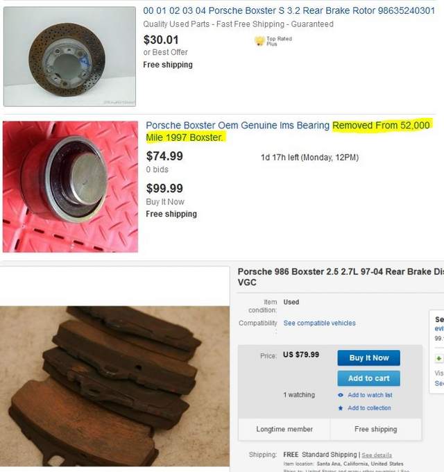

Used clutch? I don't think that sounds like a good idea. The biggest cost to the IMS is taking out the trans which you have to do to do the clutch. Your best bet, borrow the money and fix it all at once with new parts. You will be very happy. It is a far cry from a sentra to a boxster so doing it yourself is probably beyond your skill level if you have not worked on Porsches before. You have to expect that owning a boxster is expensive but I bet you got a great deal on yours considering they were very expensive when new. If it is going to be a daily driver, you better set up a repair fund. It can easy a few thousand dollars quite easily at ay time

Originally Posted by apswater View Post
Used clutch? I don't think that sounds like a good idea. The biggest cost to the IMS is taking out the trans which you have to do to do the clutch. Your best bet, borrow the money and fix it all at once with new parts...
Of course for all the labor involved in replacing a clutch, it is best to go with the highest quality, brand new clutch you can reasonably get. There are good opportunities to buy a 'purchased, but never installed' clutch. If you are Very short on cash and need a clutch a slightly used clutch from a wrecked car will be adequate.
Here's a sampling of USED stuff available on eBay at the moment. The fact that someone is selling it does not mean that it is suitable or sensible for use:
BTW, I have 2 gently used AOSs available if anyone needs one.

NOOOO
read the manual!
Thanks! My oil looks to be right below the max.
I think I'd rather just buy some parts new. Why would one pay $100 for an IMS that was driven on 50,000 miles when you can get a new one from pelican for not much more.
...I think I'd rather just buy some parts new. Why would one pay $100 for an IMS that was driven on 50,000 miles when you can get a new one from pelican for not much more.
Just to make sure it's clear, I was pointing out what some people will sell used. Not what anyone should buy used. A used IMS bearing is guaranteed to fail:
