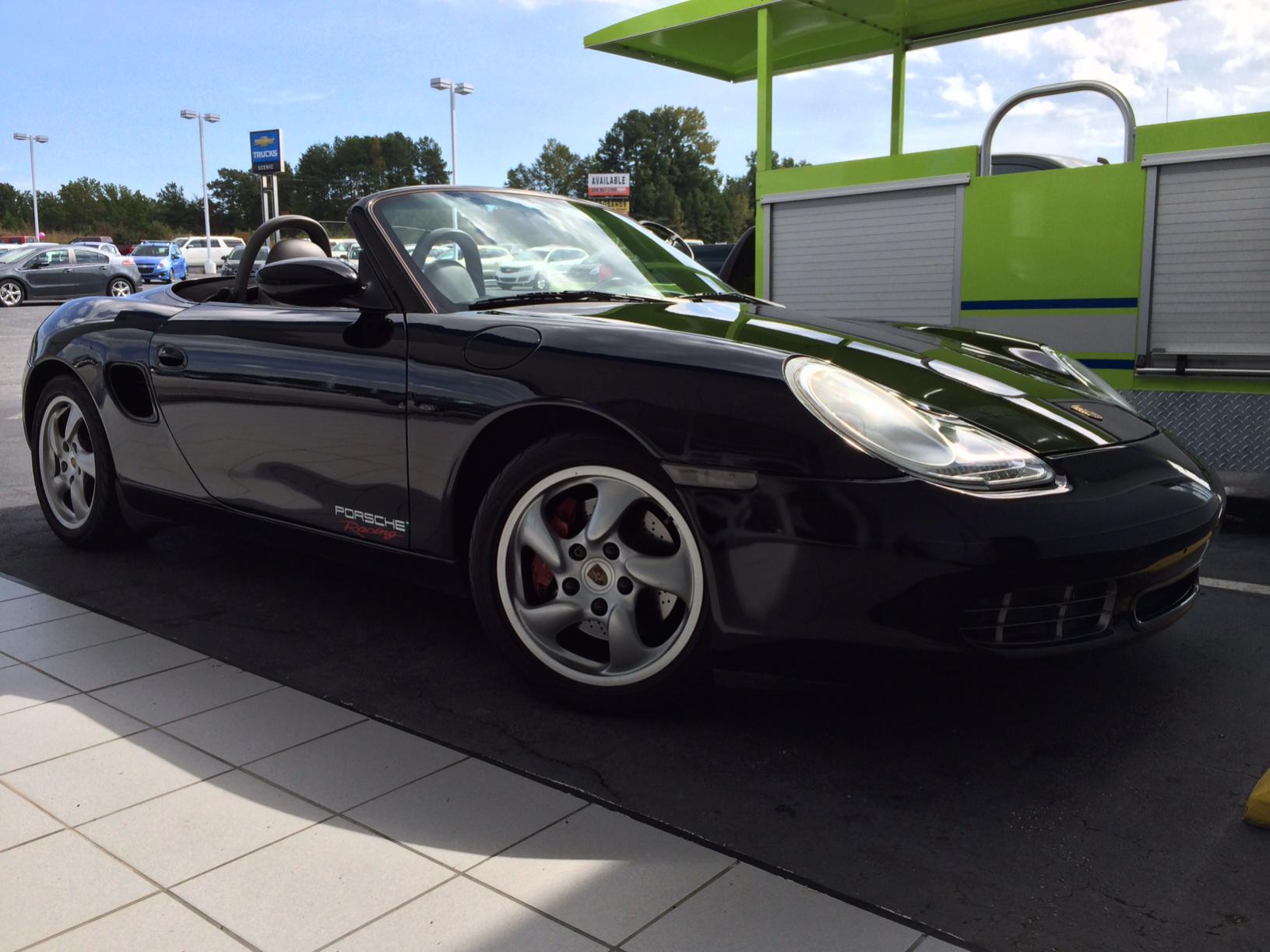

my new box
fastfeeet is offline   Reply With Quote

Effen a BEAUTIFUL

Randall, I will drive it like I stole it, thanks for the info. My Z4 was rear ended and totaled, it was redlined and raced in the mountains where I live on a daily basis, and had 167000 on the odometer and seemed to love it. Im looking forward to this car, it seems to handle better and has more power, im a little cautious tho because of no stability control.
Anybody know if those Porsche racing decals are factory? Im thinking of removing them.
Thanks for the responses

Decals are not factory, I would remove them. I have never had an issue with no stability control, but be careful on those narrow mountain roads.

Posts: 1,466
I've seen these on several other Boxsters
I have considers adding a set just below the air inlet vents. It's a nice touch on all black

Nice looking. I'm not normally big on decals but they're a nice addition.
