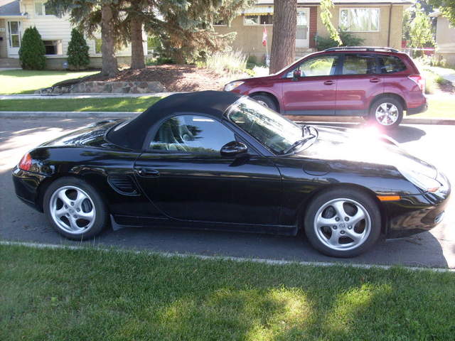

I need some help pricing my car for sale privately...
I have a 2001 Boxster base. 45,000 miles(73,000 kms).
The plusses:
4 new Michelin a/s tires
Ims Guardian installed
Everything works - a/c blows cold air, top goes up and down
The minuses:
Spoiler disabled
Code P1341 reset. No CEL light showing.
Indy shop diagnosis as follows:
Cam angle adjuster bank 1 and 2 are working in sync with same values
Cam position 1 deviation 9.86 degrees to crank
Cam position 2 deviation 6.25 to crank
Cam adjusters and solenoid working normal
Cam deviation does not change thru rpm band
Enging timing checked within manuf. specs.
Recommended ims replace with crank seal. So I am looking at $3k-5 minimum with clutch etc and am not willing to spend that as I want an suv.
Guidelines. A local 2001 Boxster base with similar miles is selling for $12000 and a 99 for 10000. These are Can $ so for US it is 10% less.
Boxsters sell used for more in this part of the world. US and Can members of this forum please give me your ideas of what I can list this for. Snow starts flying in about a month! Thanks in advance!
