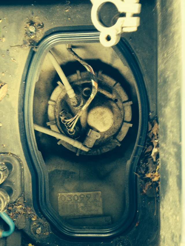

I am going to go and look at the sender unit now see if I can spot anything obvious. Will take a pic and report back.
I am hoping it's just a loose connection. I wish.

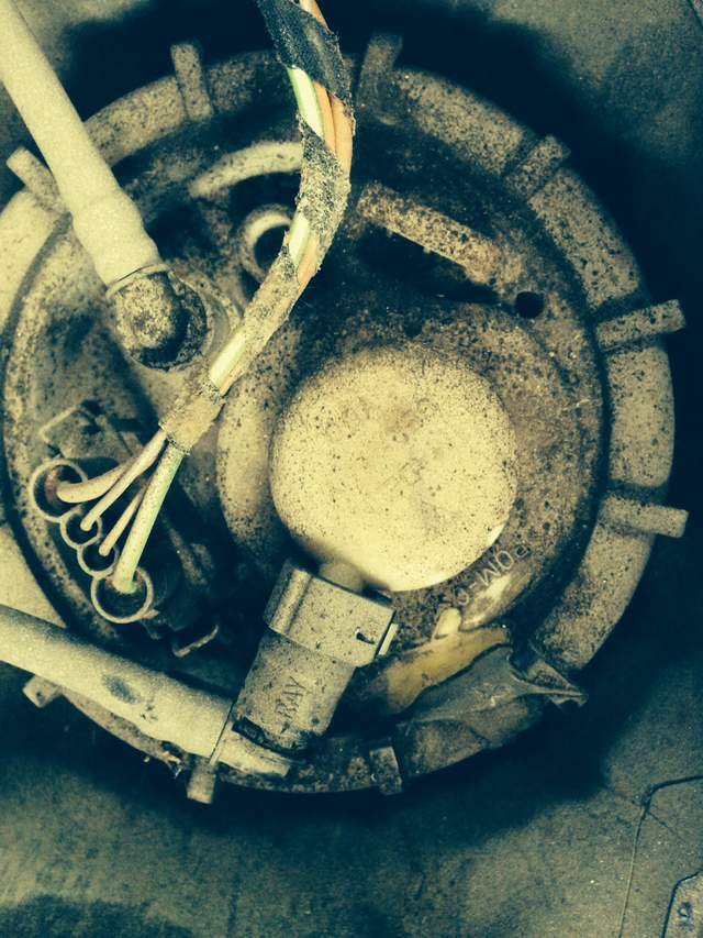

Looks as though it has had a 'glue repair' previously. Guess that looks like a crack which tells me I need a new fuel sender.
Now need to decide whether to do DIY or take it to the garage
The glue is on there as a tamper marker to show if it's been removed prior. Mine had it on there, too.
I thought something like that after I wrote it. I looked at the pics of others and they had the same. Thanks for that. I will get my hands dirty again and get right inside this time.
