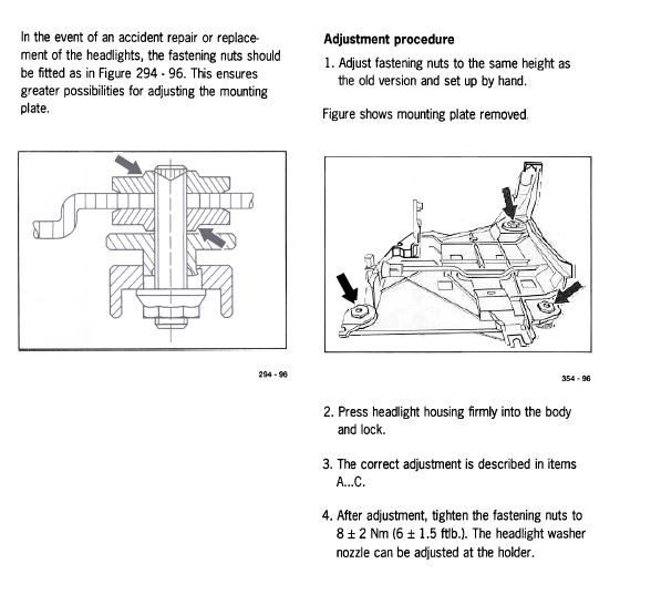

You need to loosen the Torx screw, then take off the 19mm nut around the Torx. After you do that to all three you can take the whole plate off. You may have to hold the nut thing on the underside of what you are loosening. I'm now trying to figure out how to adjust the plate. If you happen to figure that out let me know.

Correction. You don't actually need to loosen the torx screws. I just had to turn them a little to break the 19mm nuts loose. I think i have an idea how to adjust the height now thanks to the link you posted. I should have read that first

Yes it is lol. Yeah to get the whole mount off you just need to get those 19mm gold nuts off the top. If you loosen the torx screws too much then all the stuff underneath will be able to move as well. If they move around it may be hard to get the mount back in the same exact spot as it was. That's the problem i'm having. The light sits back to far in the fender and looks like crap. It has always been like that since I bought the car. If you were to just loosen all three torx, then I think you can move the mount forward and back. Up and down is another adjustment you can make too.

if it helps
