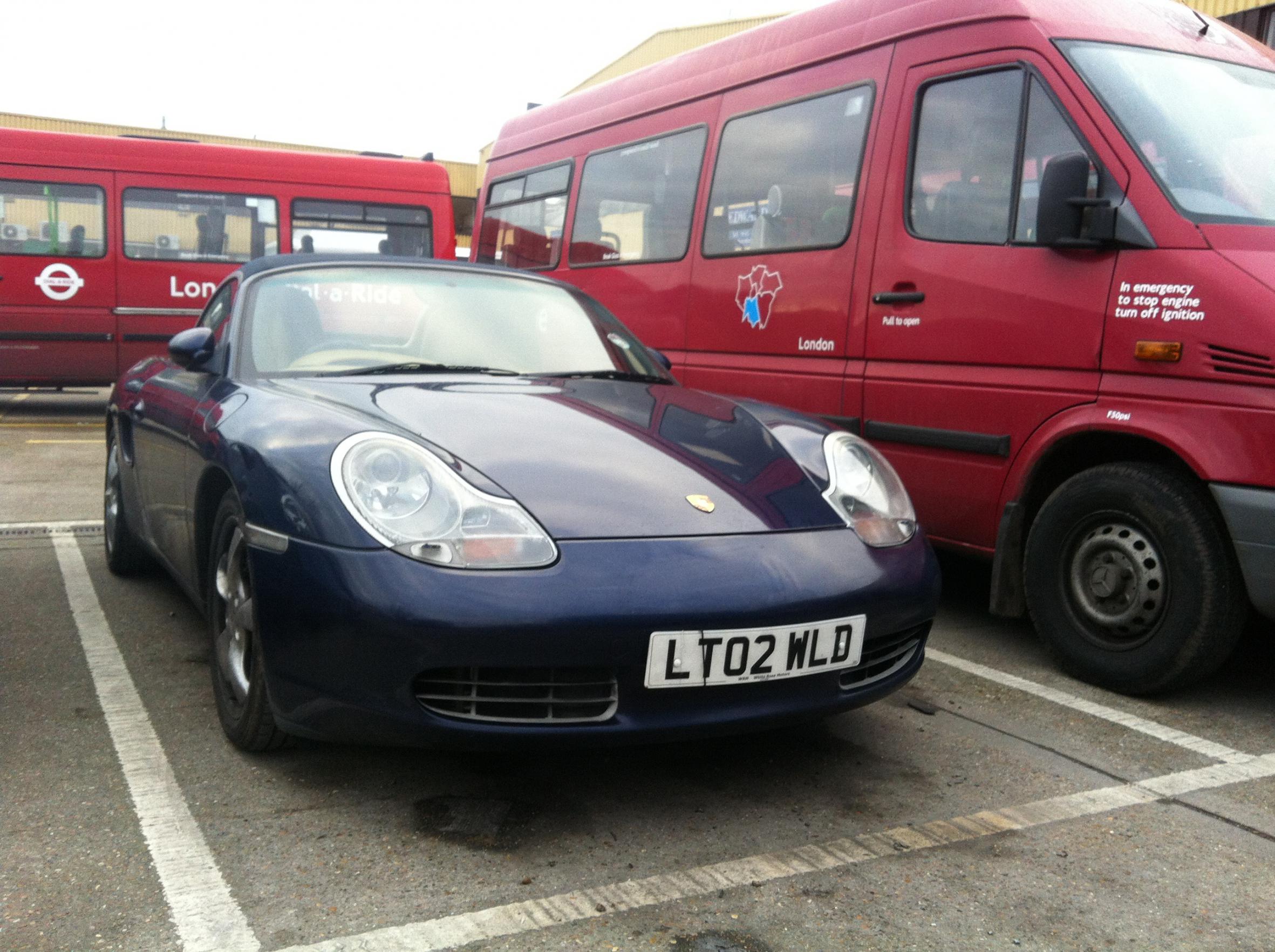

Congrats But it didn't happen without pictures
My first photo, taken at work first thing this morning. The drive to work was far more enjoyable today. My "company car" a Mercedes Sprinter bus, is just behind.

Outstanding color! Looks great, enjoy the ride home!
