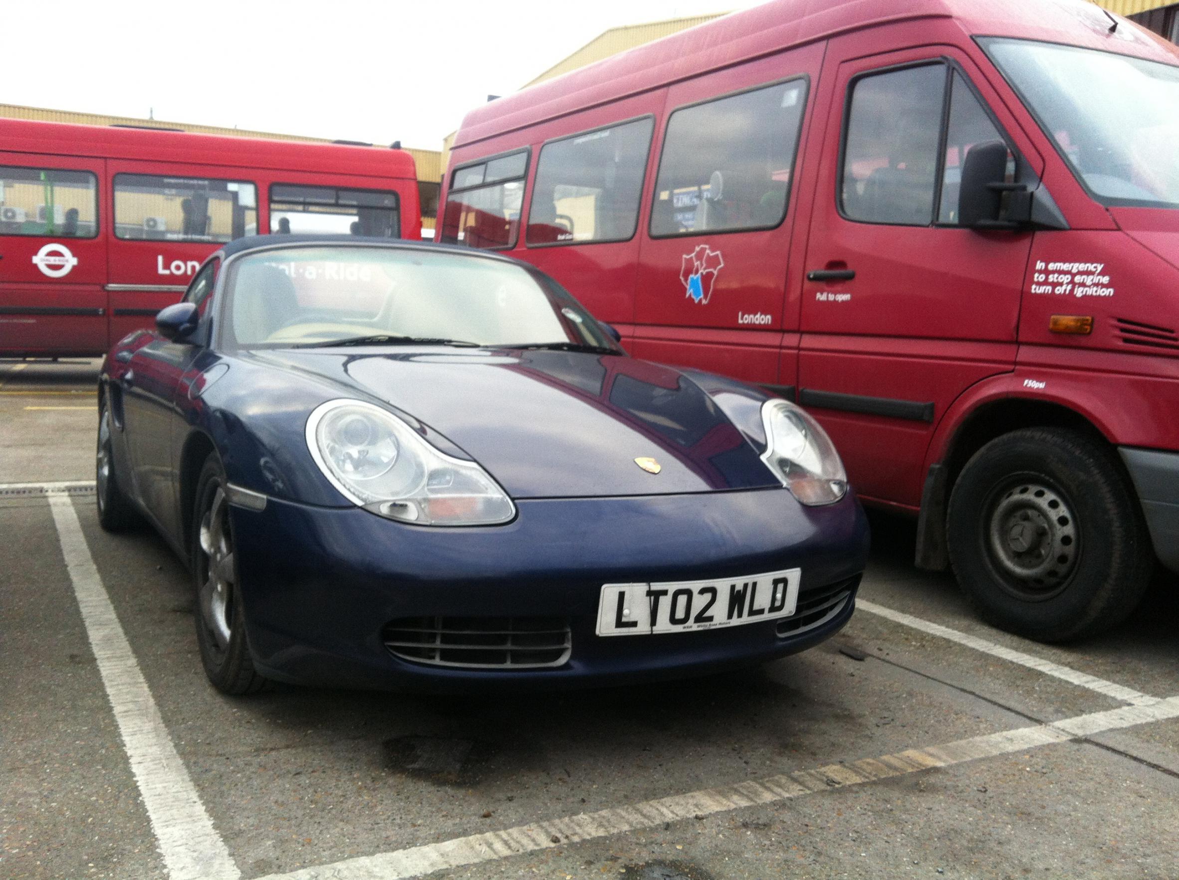

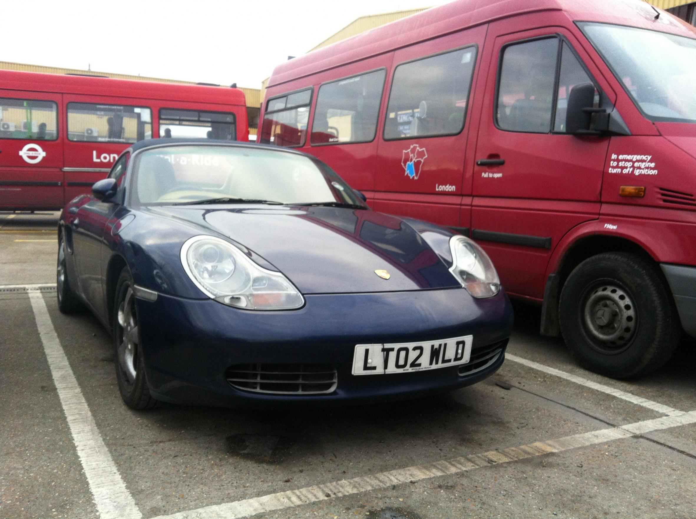

My first photo, taken at work first thing this morning. The drive to work was far more enjoyable today. My "company car" a Mercedes Sprinter bus, is just behind.
Attachment 18216
BruceH 02-19-2014 08:39 AM
Outstanding color! Looks great, enjoy the ride home!
