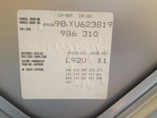

So I got the Bentley Manual and have been reviewing my Option Codes:
XAA-Aero kit, front spoiler, rear spoiler, rocker panels
XLA-exhaust pipe tip?
XMY-roll bar painted silver same as car
XSC-Porsche crest stamped in head crest of seats
X71-Istrument dials in aluminum look
222-Traction Control
224-????
236-????
413-18" Turbo look wheels? Mine have 17" wheels from PO?
446-colored wheel caps
454-cruise control
490-HiFi sound system, 6 speakers, amp
502-?????
551-wind stop
584-?????
692-CD changer Porsche CDC3
Does anyone know what the codes are that I put question marks after? They aren't in the Bentley manual.
thanks,
James

224 - Automatic Limited Slip Differential
236, 502, and 584 don't exist
986online.com- Boxster Option Codes -Porsche Boxster Parts And Accessories.

502 might have been a car cover
584 storage box on engine cover

Here's the tag.
236 - 18" Alloy Wheels
502 - Valmet Production (Finland, Uusikaupunki Built)
584 - Storage Box above Engine

And here's the entire published list for the 986 models: http://www.renntech.org/forums/index.php?app=options&do=box986&max_results=10&sort_key=code&sort_order=asc&search_keywords=&st=0
Options available often varied by model year, and definitely by model (986 vs. 987, etc.)
