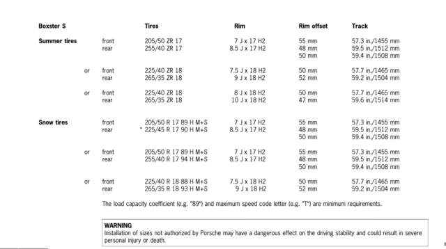

I have the opportunity to get some 255/35/18 Pirelli pzeros for very cheap.
Do you guys think this would hinder the performance on a boxster s compared to running 265?
I know that spec boxsters usually run this width or even square but im not sure about a street car that see's the occasional track day.

No, I think OP is inquiring about the size which is to small for a Box rear.
Reduces load carrying capacity while increasing tendancy for sudden oversteer.
Puts more miles than actual on odometer.
Shorter tires on rear than front upsets handling balance.
Pirelli have been highest maintenance brand name tire during my experience with them.(1985-2002)

^^ What BYprodriver said.
Spec Boxster's are probably not the best comparison. While they do run 255/40/17 rear, the cars are purposefully set up for less understeer/more oversteer to acheive as close to a neutral handling car as can be acheived. Without the requisite driving experience, this setup can feel darty on the front end and loose on the rear end. This is generally not ideal handling for a street car.

Thanks for the good info.
I won't be getting the PZeros.
I also have the opportunity to get a pair of 255/35/18 Michelin Pilot Sport 2's for very cheap also.
What do you guys think?
I know the Michelins are very good but I am skeptical on the sizing.
Would these be okay as a temporary alternative since I have KW V3's and could dial in the suspension so I would not get snap oversteer?

After I get new tires for the rear I will get an alignment and corner balance.
I guess my question is,
Is it worth it to get the michelins in the 255 size for much cheaper or just buy the 265s which are much more expensive?
Will I lose a noticeable amount of performance and grip by going with a 10mm smaller tire?
I do plan to AX the car soon also.
This is just a temporary set up since my budget is a little tight now after dishing out the money for the V3's.
Thx

recommended tire sizes
