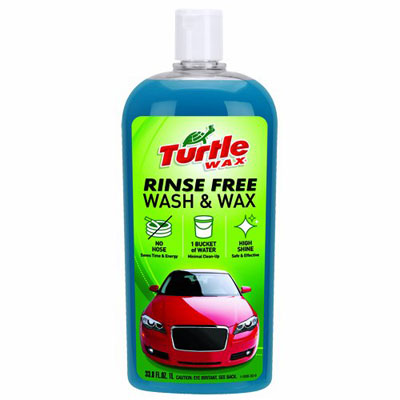

1 bottle of Turtle Wax Rinse Free Car Wash ($7) Tthis is nearly $14 at some auto stores!
At 34 oz's this is enough to do 17 washes or $0.40 cents per wash. A bargain. But check online to see if your local Wal-Mart has it on the shelf, they don't seem to carry a large stock. And the 34 oz's at $7 must be an introductory price. I bought two bottles... Optimum No Rinse, the most well known competitor in this category, is $16 for a smaller 32 oz bottle before shipping.
1 roll of Scott Shop Towels ($2)
This whole wash took about 5-7 minutes. Clean up took 30 seconds.
#1) I pre-soaked the car with about half of the first bottle of distilled water. Next I poured two ounces of the Turtle Wax solution into bucket #1. It should just cover the bottom. I then emptied out the second container of distilled water completely into bucket #1. I dunked the chenille sponge to mix up the solution and water, and in one long pass, going in the direction of the wind, I cleaned from the headlight to the rear tail light. Dunk the sponge again, give it a wring, and work your way down. Add a little more water and solution if you start to run low. Do the hood and trunk in the same way, long downward passes, no back and forth. Leave the bottom areas of the car (skirting, wheel well edge, bottom of bumpers) for last as these are the dirtiest. Obviously, don't use this stuff on the canvas top, Raggtopp cleaner there only.
2) Wheels: next take bucket #2 and pour in the second half of the distilled water from the pre-soak and add the remaining water/solution from the other bucket used to clean the paint, so basically recycle the leftover solution in buckegt #1. Dunk the soft bristtle brush and clean the spokes and lug wholes. Then wipe the whole outer rim of the wheel. I would stand behind the wheel when doing this because the solution is very thin so its going to spray all over and get on your shoes. I keep a roll of blue shop towels in the car, these work well for drying the wheels. No need to wash a dirty cloth towel full of brake dust. You may have to wet down the shop towel a little bitt to get it soft.
Rinse down: this step is optional and somewhat contradictory to name of the 'rinse free' product title, but I like to be thorough in washing away any debris that may still be on the paint without having to actually touch the paint. So just take the third bottle of distilled water wet down the car, rinse out the buckets and wash your hands. Use the shop towels to clean out the buckets.
Drying: None. Don't touch the paint. Towel drying is where most of the scratching occurs. Just get in the car and drive it fast for five minutes. When you get out afterwards I recommend doing a once over with your favorite spray wax and these Griot's towels. They have a high loft and do not feature prickly ends like typical auto store microfiber towels. Try getting them online when Advanced Auto have 30 or 40% sales (via email coupon) otherwise they're about $5 a towel in-store, kind a steep when you need to keep at least 12 of these handy. I like to use this spray wax, also from Griot's. It leaves a wet shine without having to use a paint-rubbing/swirl creating paste wax. These days I'm only using liquid polishes and sealants. All waxing is done from liquid sprays to cut down on paint rub.

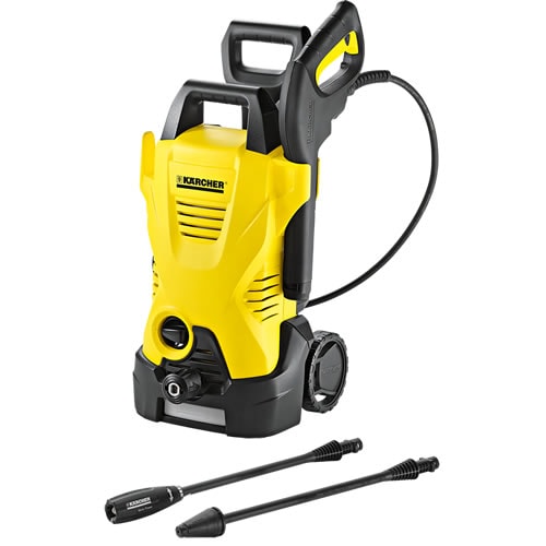

Hm, what I'm really missing in this procedure is the initial hose down to get all the abrasive stuff off the car. I don't like to touch the paint on any of our cars without first hosing them down from all sides for 10 minutes or so.
Btw, if you don't like drying your car them wash it while it is raining. Distilled water for free!

Got one of those a few years ago at half price ($95 or something). I was sick of washing the house windows by hand. Makes my cars' wheels shinny shinny shinny as well
