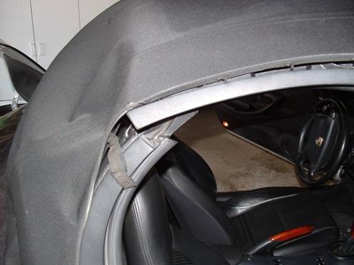

I got i leak, top needs to be aligned?
I have had problem with a leak on my passenger side for i while and after some investigation i found out i had two.
The first one was from the drip pan and that one is fixed.
When I'm driving in the rain i always got water on the floor on the passenger side.
And I'm pretty sure its because my top need to be aligned.
The question is how ?
Pics......
Driver side thats not leaking
And the right side thats leaking
Here you see that gap that needs to be closed.
Could this be done with the tension wire?

When i drive in the rain the water that travels on the window travels more o less directly to the gap. And i have stuffed the sides and the bottom of the passenger side with paper to se what way i takes down on to the floor.
*pic is coming*
I also Think that the plastic parts are to far away from each other. Seems to me as Everything should be tighter

Ok,
All the way from where the seal ends, the water travels down
There is only moist in the marked area.
And from here it travels dom to the floor.

When i see pics on other Boxsters the seals are closed and the black plastic pieces are closer together. Thats why my guess is that the seals is the problem, and on the passenger side there is a 5-6 mm gap.
But i don't know how, from what i understand theres only 2 adjustments on the top.
smygolf is offline   Reply With Quote

That was what i was thinking of doing, but doesn't the Cable only effect the "B pillar"
I just had a Little brainstorm and id did a check off the alignment of the seals.
And the B pillar seal has moved!
So with a gentle touched i removed it, gave it a good Clean. When it was loose one could see that there is a bit o play.
So Before i remounted the seal i gave it a Little bit of oil.
No it sits Perfectly, but where is the rain?!
I also have a bunch of towels where the water traveled Before so with a Little bit of luck!!!!

*Update*
Its better but there´s still water coming in when i drive in the rain.
But this area is now dry so i did something good
