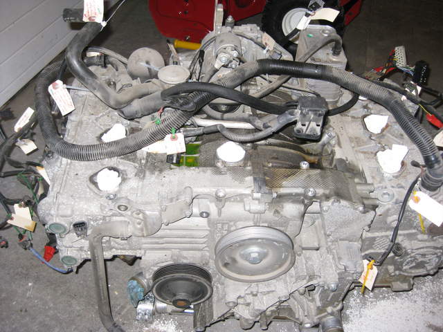

2004 S - here's is what my AOS looks like. There is only 2 flexable plastic hoses that connect to it. If you want any other pic's for clarification let me know. I took lots when I took the engine apart.

Old 08-18-2013, 05:22 AM   #5
pjq
Join Date: Dec 2010
Location: Eastern canada
Posts: 262
2004 S- Here is a partial stripped down view.
