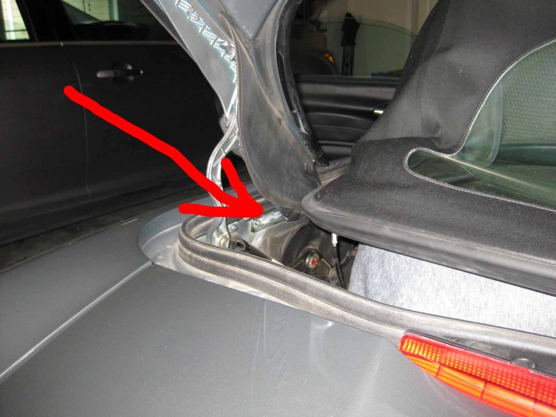

I think a lot of problems are created by not greasing the slides at the sides of the car. Proactive maintenance there can reduce the chances of binding and damaging motors/transmissions.
Something I have never done.
Noted. I will let you know the verdict when I get time this weekend.
Can you elaborate re the "slides"....
I don't think I have ever seen anything regarding greasing on the Boxster top mechanism.
+1 as this is news to me too
Old 06-20-2013, 09:10 PM   #8
I believe he's referring to the clamshell slides.
I absoluitely agree - amazing how many folks dont do or know about this tip!

Here's the reference thread. Unfortunately the pics seem to no longer be there. So I took one myself.
http://986forum.com/forums/general-discussions/19797-top-body-structural-damage.html

Thanks clickman - I wonder if this lack of lubrication is the reason my top is a little slower than I remember!! I thought it was our cooler winter weather causing it to be a little sluggish.
I'll check mine out tomorrow and lube up the slide / ball with some lithium grease.

A quick update....
Cleaned out the slides today and regreased with lithium grease (actually my motorcycle's synthetic chain lube). There was remnants of the (original ??) grease in the tracks, but its now clean and super slick.
Thanks clicky - you learn something new on this forum every day......

I greased the slides today, really a job done in minutes, and low and behold the top works smoother now. I bet this was never done since the car was new......
Great tip!
