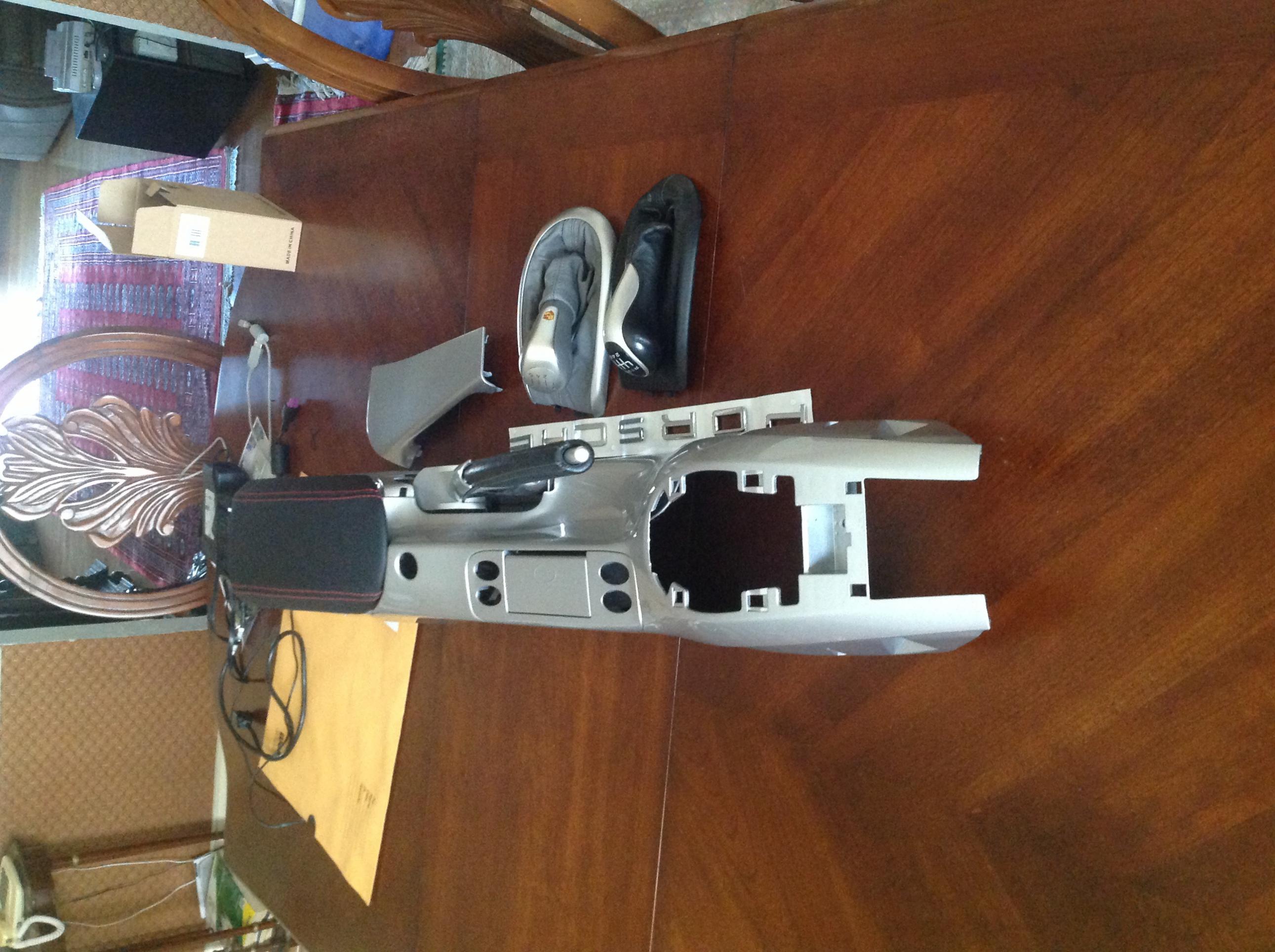

So My shift boot was MANKY! so looking around the prices were all stupid for just a piece of pleather, so i took that SOB out and put in my own.
1. remove shift boot and knob (no tools needed)
2. rip all the seams, thus getting you both templates
3. select cloth (took all of my control to keep it black, since i love me some custom)
4. sew it (sewing machine, woman folk might be useful for some)
5. glue and tie knob to new boot
6. install
(honestly took under 30 minutes, super simple)
here you see the old boot up top ripped apart to make templates, one cut out and one about to be cut out.
super easy mod, and voila! you can make the boot as tight or baggy as you want, i like the baggy look myself...
Going to paint center console/upgrade knob in next project...

Nice job on the leather. I started to do the same with a different type of P-Car and had trouble sourcing the same shade of grey leather, stumbled into a guy who sold me his unused boot in the right color so I never did any sewing.
Question: Do you need an industrial grade sewing machine to stitch the leather? When I asked my wife about sewing the leather several months back she baulked at doing it saying the leather may be too thick for her machine.
Old 04-20-2013, 05:06 AM   #5
Could you post a more straight on pic of the boot template? Maybe some measurements, too?
I've been scouring the local thrift stores for some white leather so that I can make a white boot and cover a few trim pieces in my all black interior, but would like to keep the old boot intact as its in great shape.
Love some DIY ingenuity

Coreseller: I had to use a leather needle, and go a bit slower it can always be done by hand.
Particle: I ll get you one by tonight, You could use that ebay link, or try a fabric store, they normally have all kinds of colors of leather.
Ilikeching: use a flat blade to pop the bottom of the boot up, then pull straight up while twisting on the knob! its a big yank, but the twisting made it much easier!
If anyone really doesnt have the means to make one, I'll make you one. I live in a rather country oriented town so we have all kinds of leather shops to source from. PM me
