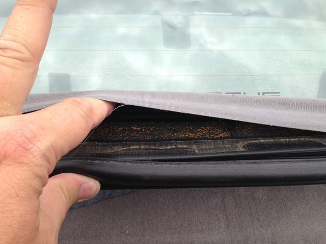

New issue
Looks like the top came "unglued". Any ideas?
