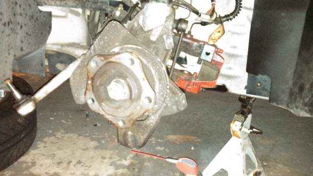

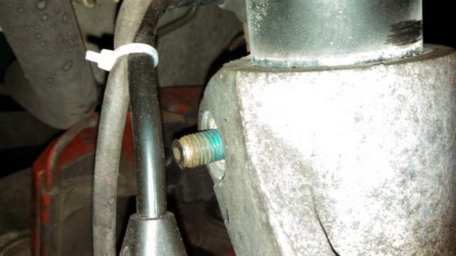

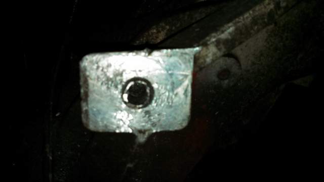

Ok I still have not finished with this job which started off as just a simple brake change.
So far I have bought 8 new bolts, a salvaged wheel carrier and now two new lower control arms. So ya the list keeps growing.
I finally took pictures so here take a look.
My bushings were shot and i bought remanufactured lower control arms from FCPEuro for $43 dollars each. Some one else on the forum had bought a set so I will let you know how they do.

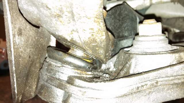

See here is the drop link bolt and I cant take it out hammered it and all so I let it be for now. I was able to remove the droplink part connected to the sway bar so thats good.

Here are pics of old rotors and new rotors.
Here is the salvaged wheel carrier.
And pics of my suspension.

That hole is ugly!
I swear, I have no idea how the guys in my field do it up north with all the rust. I wouldn't do my job if I lived North of DC on the east coast.
As far as removing the link joint with out the aid of heat, is simply an issue of PB Blaster and hammer utilization. I really feel for you.
