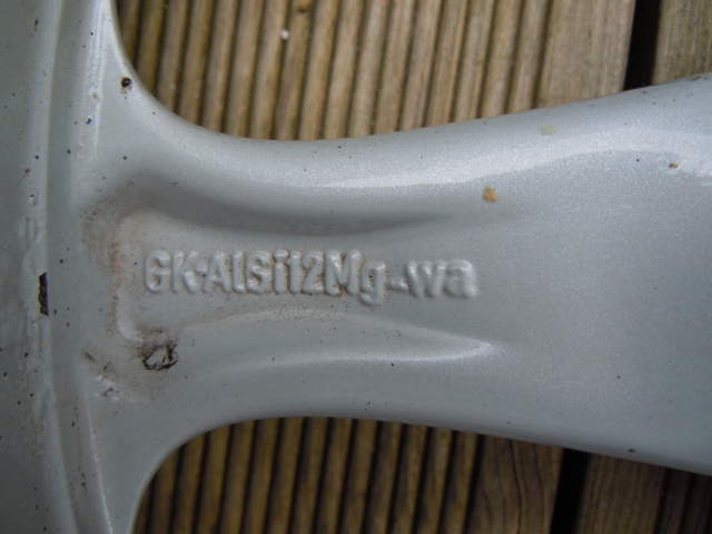

Thanks Johnny....Heres some wheel shots of the back of the wheels showing codes...
Gonna have another go today with these to see if i am missing something??
I dont think i am though......been messing with cars for years..!!

Just to confirm, this is a photo of the wheel fully mounted on the hub without spacers ?

Yep Johnny...Thats the best i could mount...wont go right in as they foul with the strut, so poss a 5mm gap between the hub flange..
Had another look today....Looks an impossible task..These wheels are 11.5 inches across with these tyres.. and imo will look s*** if i fit these with spacers.. Just not the look i want to go for... Oh well already up on FleaBay...should make a couple of bucks into the bargain..?

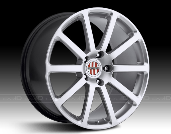

How about something like the affordable Victor Zehn wheel ? They have a nice, simple clean look to them, and they're lightweight with a good fitment for a 986. In addition, they're available in both 18 and 19 inch.

SO....Victor Zehn wheels it is...decision made
New and shiny and wont have to refurb anything...
All i gotta do now is decide what size 19s or 18s and tyres to fit OMG
would rather stick with a 40 profile tyre if a i can...but the 19s look favourable at the
moment....cant do anything until Monday now...so will decide by then
Found this pic of a members car with them fitted...Have PM`d him...
trying to find what size wheels, and tyre profiles he is using if anyone knows the car??
Think these look great and fill the arches up nicely...although i suspect the car may be lowered??
He's running 19's - with what I believe are H&R lowering springs.
