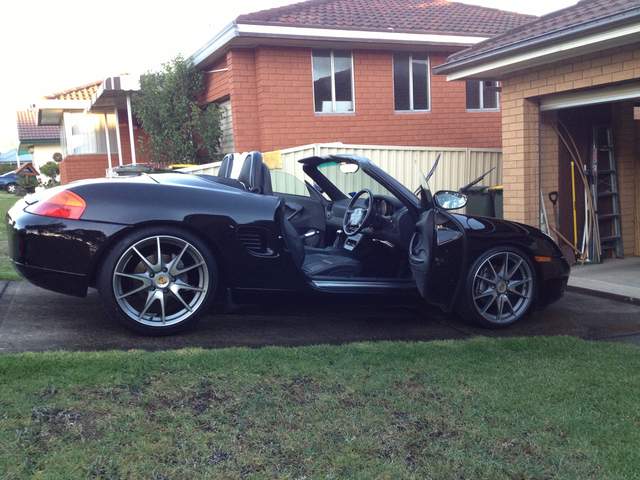

I have a set of 19" on my 1998 and they look and feel perfect.
