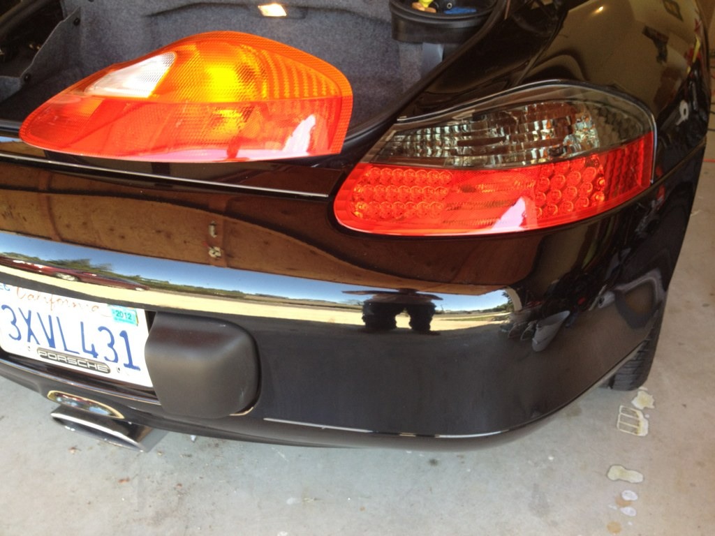

The Depo units must have some resistance built in, as they work fine with any issues. The side bulbs are an odd issue , as they could have just simply drilled a hole in the inside lateral housing and the mini bulb would fit thru. I may do this as a winter project.
Otherwise,My biggest gripe was the depo lights wires that plug into the oem wiring harness were too short to reach, and after several attempts to get them to fit, I cut the wiring, and soldered on some extension wire. Also, there is no room for the left rear fog light, although I never used it anyways.

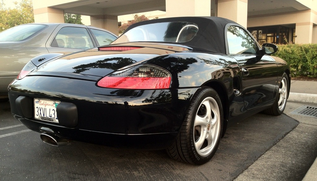

Here's another pic of the lights. I'll take some more when if I get away from the family this weekend.
I'll try to get an evening shot so you can see the lights in action. They are reeeaaalllyyy bright. I looked at my rear view at a stop light last night, and I could see the girl behind me fully illuminated in red!

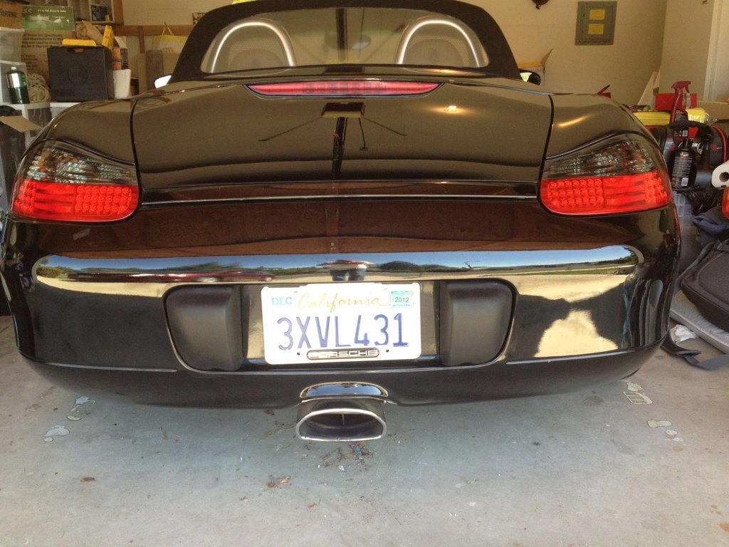

Actually did the whole car with new lights, the old ones were getting faded.
