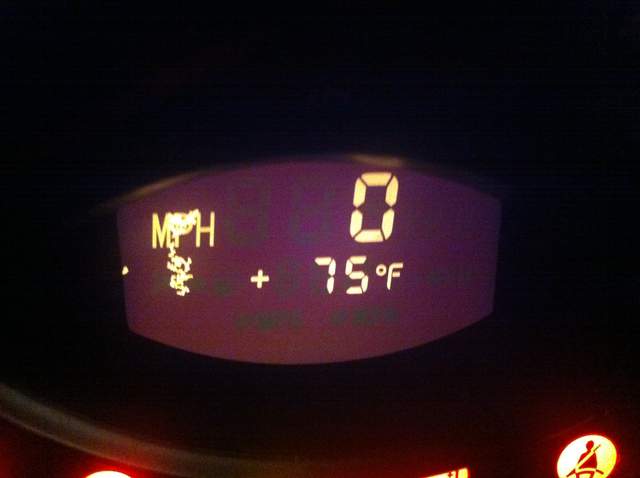

What's wrong with my digital speedometer?
This just recently happened. My '99 Boxster is not my daily driver, but just my "fun" car to drive on pretty days. I got in the car a couple of days ago and noticed this "scratching" by the digital readout. Also, after driving a short distance, the check engine light came on, stayed on for about 15-20 minutes, then went off again. Any ideas?

Donna pwis cables are meant for dealer repair and cost a lot. It would be cheaper to replace the entire cluster than to buy a cable in hopes of a reset, besides this problem doesn't look like a reset issue to me; looks like some kind of permanent display damage just my 2 cents. Another idea would be to go to a dealer with pwis and negotiate a reset, just know it might not work in your cost calculations, good luck.

It looks as if something is scratching it from behind. It is weird. Could there possibly be a loose wire or something behind there?

Tiny cats... Tiny tiny cats....

Loss of liquid crystal resulting in cavitation
Sometimes called crazing, though this is incorrect.

It looks like you found the etch-a-sketch function.

Your LCD is gone. It can not be replaced unless you have unusual elect. repair skills.
If you want it corrected you will need a new instrument set.

FWIW, the HSC ribbon is really easy to remove and reattach if the proper tools are used. These are 180°C ribbons.
If you have this problem, you can find a bad cluster with good LCDs and swap them out

I had the same problem with a 996 cluster that I swapped into my car. I couldn't find anyone willing to swap lcd's for me and I didn't think that I had the required skills. You can read about my experience here:
http://986forum.com/forums/general-discussions/43017-carrera-gauge-swap.html
FWIW, the information provided to me indicates that the problem with the lcd's is caused by contaminants that get between the layers of materials during the manufacturing cycle. Time and perhaps temperature change eventually cause the layers to de-laminate and the result is what you see in the original post. This seems to make sense, but I have not seen any information from an official source confirming it. Considering that Porsche eventually adopted a dot matrix displays in lieu of lcd's seems to confirm that this was a flaw with the technology or manufacturing technique.

However there is another way to accomplish the same result. What you need to do is swap the entire board with the lcd's from your 986 cluster to the 996 cluster and then program the 986 board to think that it is a 996. You can actually swap the board and everything except the voltmeter will work fine without the programming. There may also be a speedometer error. The only special equipment you need is an EPROM programmer and a clip to attach it: http://www.amazon.com/GQ-4X-Universal-EPROM-programmer-full/dp/B009N9HHL4
