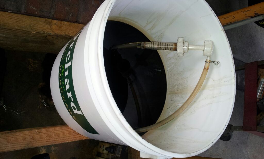

OK there is no way this can be right. I drain over a gallon of oil out of the valve cover!
Is there a port from the oil pan to the timing cover area?
Sent from my SAMSUNG-SGH-I717 using Tapatalk 2

HS
As you probably know, there are 3 oil pumps, one in the crankcase and one in each cambox / valve cover.
If you drained a gallon (+/- 4 litres) of oil from ONE valve cover, that's nearly 50% of the total engine oil capacity.....
What does the oil level on your dipstick look like after everything has cooled and settled ? Low?
Looks to me like something ain't right with the oil scavenging pump or oil return path - where does the pump discharge to?
Perhaps one of our resident professionals can chime in on this....

You could also have an obstruction inside te engine oil passages that return the scavenge oil from te cylinder head into the crankcase and then down to the swirl pots to be defoamed.
We see intake valve stem seals go bad that cause as much oil consumption and chamber contamination as anything else, which is something else to consider.
The pumps are also installed incorrectly in their bores or the body is disassembled and phased incorrectly into the housing. If these things happen it won't move any oil.
