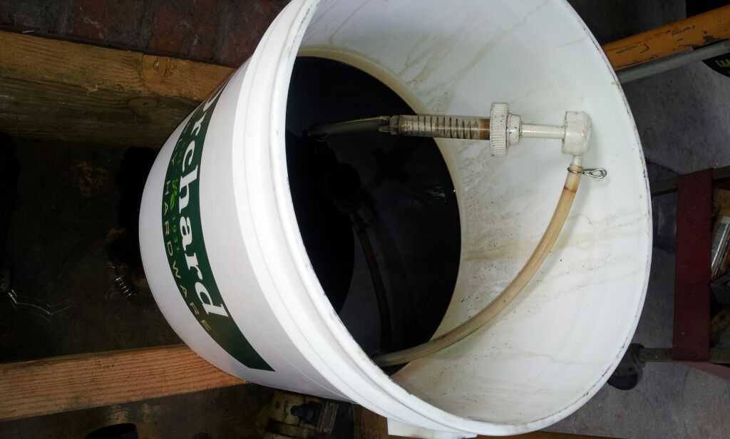

OK there is no way this can be right. I drain over a gallon of oil out of the valve cover!
Is there a port from the oil pan to the timing cover area?
Sent from my SAMSUNG-SGH-I717 using Tapatalk 2

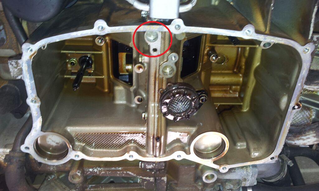

You could also have an obstruction inside te engine oil passages that return the scavenge oil from te cylinder head into the crankcase and then down to the swirl pots to be defoamed.
The pumps are also installed incorrectly in their bores or the body is disassembled and phased incorrectly into the housing. If these things happen it won't move any oil.
Well this sucks. I really hope I changed the clocking of the pump in the housing by mistake when I inspected it. I spun the shaft clockwise (looking at the shaft) in oil and it blew out oil from the correct port. I blew air into the valve cover pickup port and no blockage. I pulled the pan and blew air into the output pressure port and air came out freely from the drivers swirl pot.

Jake, have I covered all the things that can go wrong? the cam plugs seem intact.
The oil in the intake and AOS basically tells me the valve stem seals are not the issue.

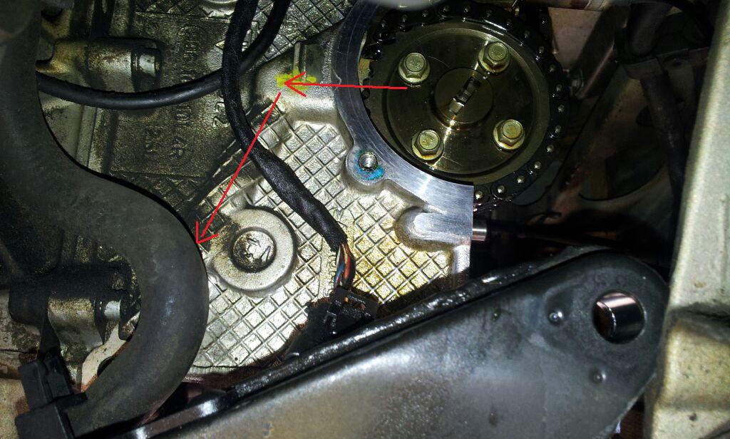

This picture almost looks like there is an arrow drawn the other direction in black marker.
