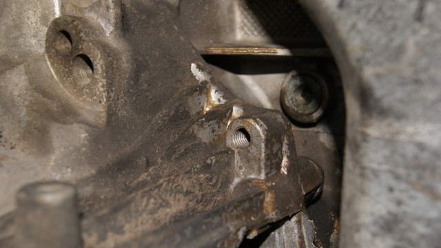

Missing bolt part (999-072-009-09), can't wait to see the hack-up work that has been done in the past.

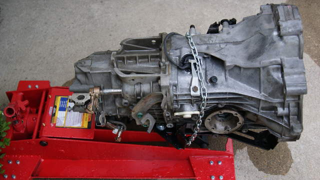

kashmir 08-08-2012 10:46 AM
http://986forum.com/forums/uploads01/0081344447898.jpg

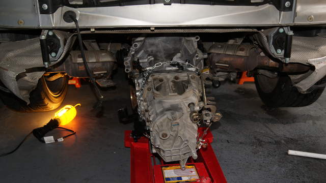

Pulling transmission

Need to pull intake for transmission to clear, replace with Pedro's mod on his website.
http://986forum.com/forums/uploads01...1343321220.jpg
This is an interesting fact as I was also missing the same bolt on my 98'. Wonder if this is common.
kashmir 08-08-2012 11:13 AM
http://986forum.com/forums/uploads01/0031344449547.jpg
De-greased transmission.

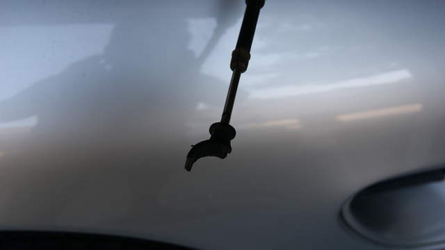

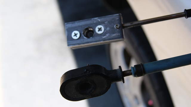

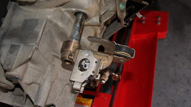

http://986forum.com/forums/uploads01/0151344449910.jpg
My manufactured by Yugo shift linkage is in very bad shape, going to see if I can have new ends made.

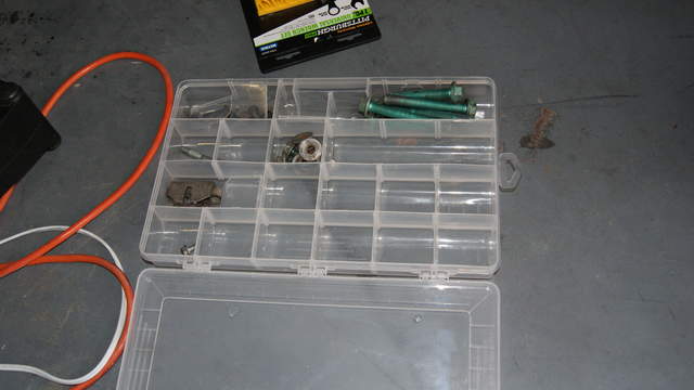

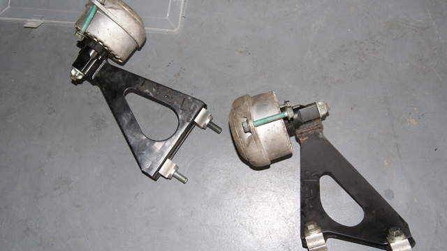

kashmir 08-08-2012 11:29 AM
http://986forum.com/forums/uploads01/0091344450292.jpghttp://986forum.com/forums/uploads01/0101344450339.jpg
http://986forum.com/forums/uploads01/0131344450378.jpg
Getting stuff organized for tomorrow.

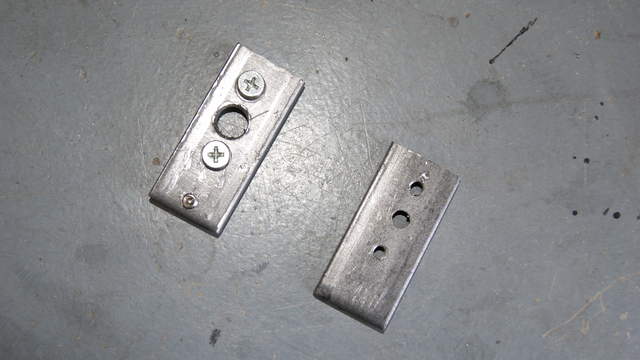

kashmir 08-09-2012 02:08 PM
Replaced the Porsche/Yugo shift ends with DIY ones.
http://986forum.com/forums/uploads01...1344546376.jpg
http://986forum.com/forums/uploads01...1344546329.jpghttp://986forum.com/forums/uploads01...1344546438.jpg

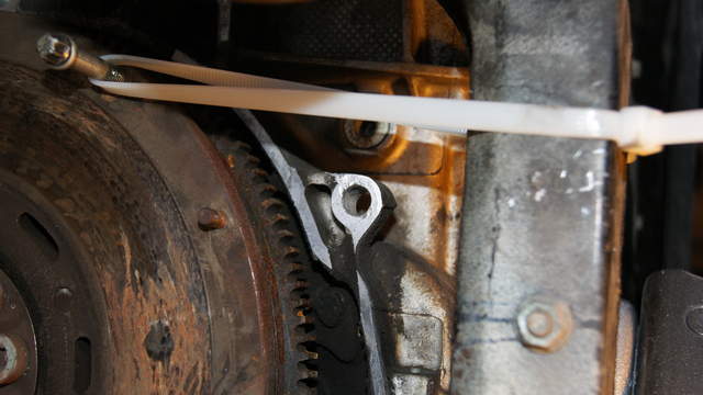

http://986forum.com/forums/uploads01...1344979719.jpg
Lock flywheel with big zip tie.

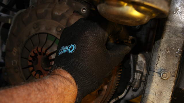

kashmir 08-14-2012 02:37 PM

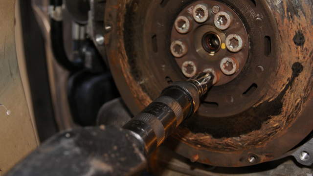

http://986forum.com/forums/uploads01...1344980027.jpg
Use hand impact to help loosen bolts.
Then use breaker bar to undo bolts, then remove flywheel.

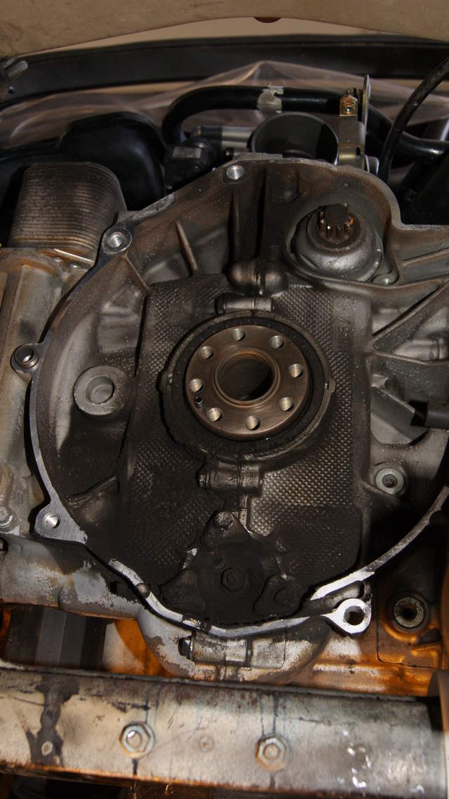

kashmir 08-14-2012 02:43 PM
http://986forum.com/forums/uploads01...1344980492.jpg
Finally to the back of engine. Nice no oil leaks.
kashmir 08-14-2012 02:50 PM

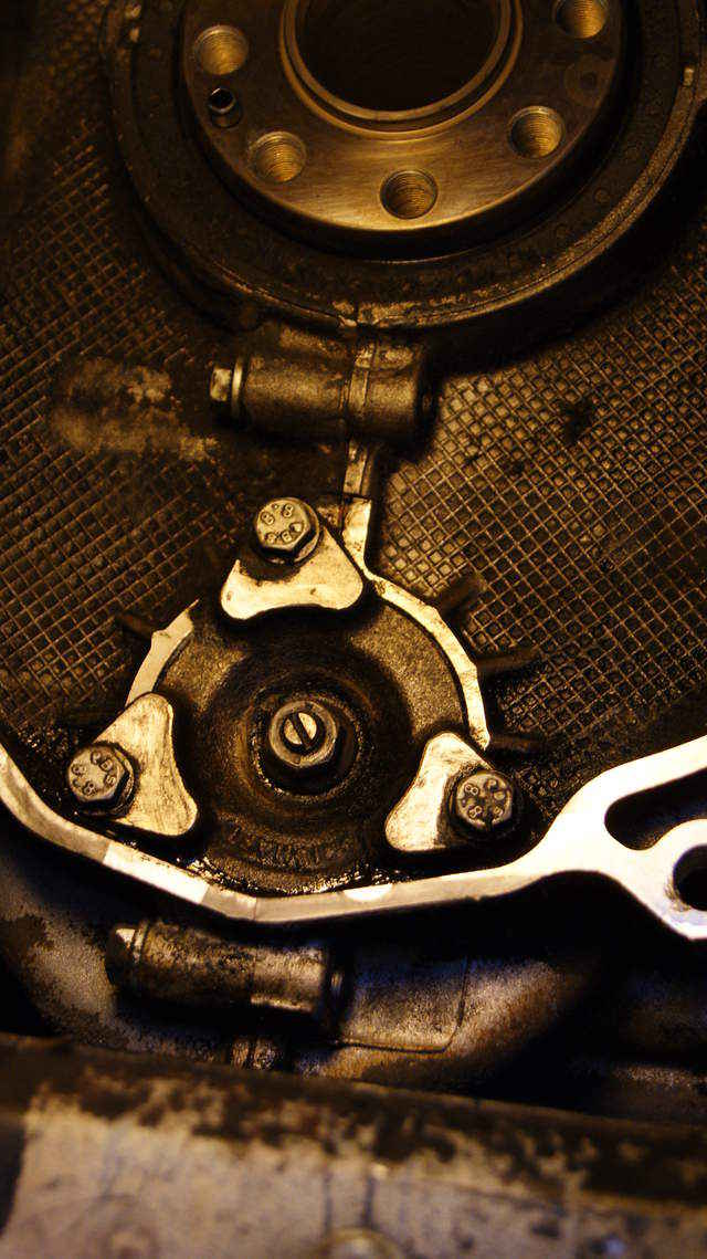

http://986forum.com/forums/uploads01...1344980893.jpg
The ims bearing cover.
