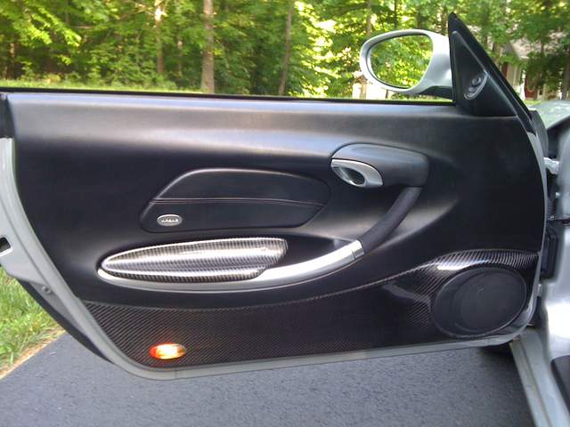

Yeah, the laminate in the 2000-2004 interiors is pretty weak. I originally recovered my arm rests with leather and it looked better then stock. I sourced the leather from a $7 coat I bought at a thrift store. A couple of years later I changed it all for suede. Now, I've finally done it in carbon fiber. Whether you chose leather, paint, carbon, or whatever, the work's not tough or expensive, just take your time and prep everything really well and it will turn out great.
