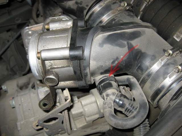

I did my throttle body and intake tubes, removed all and cleaned then reassembled. There was no need to do anything like that for my e-throttle. I cleaned the MAF and my K&N filter as well. My only issue was my own stupidity of reconnecting the AOS hose to the throttle body with arch facing back. Created Vacume leak. Needs to arch to the front to seat tightly (in my case)
I thought that was the case too, however my car decided to have a mind of its own.
When I started it immediately after cleaning the TB, it idled no lower than 2000rpm and when I blipped the throttle, it would just sit at whatever RPM I took it up to, like the throttle plate was stuck.
I ended up taking everything apart again to ensure the plate was moving freely only to find out it was still having the same problem.
It was only after doing the e-gas reset that it idles solid as a rock now.
I also cleaned the AOS tube, intake tube and intake runners while I had everything apart.
As a result my throttle control is extremely smooth. I was having issues with throttle response delay causing me to stall or randomly over-rev the engine to avoid stalling.

I'm having trouble getting this hose connector off. Any suggestions?
clickman is online now   Reply With Quote
Old 08-24-2013, 12:27 PM   #24
Join Date: Jan 2007
Location: BC
Posts: 1,354
Got it. Have to push top and bottom exactly centred on the ribbed sections, enough to release it on the sides.
How much oil should there be in that hose? I stuck my finger in it and there was enough to drip off the finger. AOS shot?
