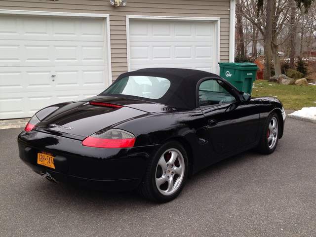

Actually Shawn's pic is exactly how mine look, neither of my photos seemed to show a real life representation of them. On my Guards Red they look really nice, I've not had one person say anything but positive which surprised me for an inexpensive after market system.

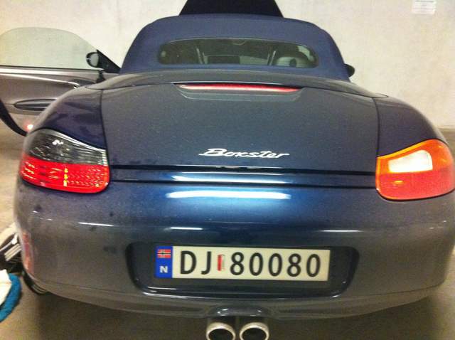

You don't lose the parking light after all. But strangely after i start the car and turn on the lights the rear lights will only turn on if i turn the lights off and then turn them back on again. Also, its a good idea to have some touch up paint handy. I had some chipping under the old tail lights and Depo lights have a slightly smaller footprint which revealed the paint chip.

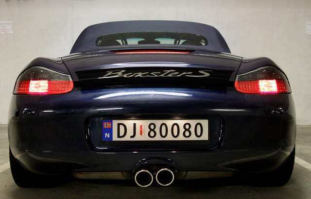

Wow these LEDs are way bright. I had the parking light on around dusk, still plenty of daylight, and you could see it bright as heck a block and a half away. Excellent for distracted drivers who get too close to parked cars. And lately I have become paranoid about parking to close to the curb, i will often park around the corner but sometimes its unavoidable. This mod gets six cylinders on the bang for buck scale.
