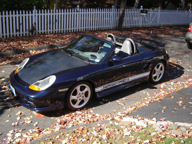

Just bought my first Porsche! a 1997 Boxster.(photo) A few questions for the experts-
Hi Guys!
Just wanted to introduce myself and see if you could help me out with a few things.
I just picked up a 1997 Boxster, w/ approximately 75k miles. The car has a clean car fax and it was very well cared for. A few of the modifications include: L.E.D. tail lights, spoiler, gt3 style body kit, carbon fiber hood, and upgraded 18" Porsche wheels with P Zero tires.
I bought the car knowing it has a few minor (hopefully) issues, and I would greatly appreciate your help!
1) On a cold start, the car puffs white smoke for about 15-30 seconds out of the exhaust. I drove the car about 100 miles home yesterday and the gas may have been sitting for 6 months or so. In my brief research, it sounds like this is normal- should I worry about this?
2) The passenger door will not lock. Is this also a common issue? I've tried the remote, manually inserting the key, and also made sure the battery was fully charged. Is this most likely a broken lock system? I have a replacement part, however it's not from 1997 and the plug has 9 pins instead of 8 (which I know need)... Should I simply replace the lock mechanism?
3) An indicator for the trunk (or is it the spoiler) has turned on and off intermittently, (usually lasts until I begin driving) any way to resolve this easily?
Thanks, I look forward to contributing to a great forum!

The spoiler indicator light is normal. That was the first thing I asked about when I bought my S a few years ago! It should, or at least mine does, come on for the first few minutes of driving. I wouldn't worry about it and I'm sure someone has a lot better explanation as to the "why" part..
The smoke could be normal due to the characteristics of the flat 6 but you say it lasts 30 seconds??? That would make me lean towards the possibility of an AOS failure. Do a search on this forum and there will lots of info. Not saying it is that, but it could be.
I'm not sure on the door lock problem, but once again, I 'm sure there's lots of info on this wonderful forum. I just haven't had that particular problem yet.
sean
+1, And manual control for spoiler is loc. on drivers side of the car it is loc. on the fuse box it is a small black switch.

just thought of another thing
I just noticed you have an aftermarket spoiler. Is your original one still there? Is that one mounted to the trunk or down into the area of the original?? I saw one at a car show awhile back and the whole trunk and spoiler area had been changed. I guess if you take jbs986's advice on how to raise and lower the spoiler you'll know soon enough.
sean

Yes I have the original spoiler and the aftermarket installed. The light goes off after a minute, so I've decided I'm not going to worry about it.
I've seen some great cars here on the forum and I've been inspired by some of the mods. Can any one point me in the right direction to remove the amber from my front lights?
Thanks again.

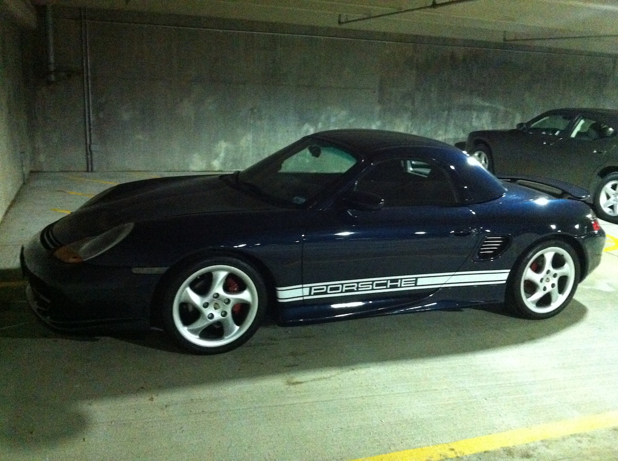

I bought the car with some mods, and I'm looking to pretty much keep it the way it is. The car was repainted when the body kit was installed ($4000 paint job, matches OEM quality) and looks showroom ready when its clean! I'm tempted to put the original hood back on the car, not sure if I'm feeling the carbon fiber look. Any opinions out there?
Update regarding issues:
As far as the smoke is concerned, it does continue for over 30 seconds- but I'm starting the car only once a week and the car is mainly garaged in the winter. Could it simply be the temperature here in New England, and the fact the car is sitting a week at a time? The smoke isn't sweet smelling so I'm assuming its oil.
I do plan on taking the car for a quick spin on nice days over the winter, as long as the roads are clean. Perhaps I'll take it to one of the recommended Porsche mechanics in my area.
I installed a new lock assembly on the passenger door, which I bought from VW ($300 cheaper than the $500 Porsche part, and the same exact part #) It works and locks but I cant unlock it unless I reach over and pull the door handle.
Right now the car is sitting as I impatiently wait for Spring 2011! Does anyone have any advice regarding service, etc before then?

yeah you know that does look a bit darker than Lapis blue in that picture.
Looks great with the hard top. Post a few more pics of the rear spoiler. If that's the factory Tequipment unit those are rarely seen. I always thought some graphics on top of those would look cool but since you already have door graphics it would be a bit much like when someone wears a ring, a watch, a bracelet and a pinky ring.
